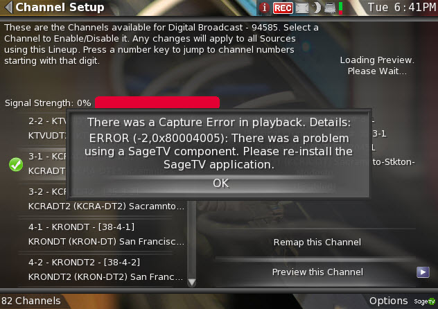

I recently installed SageTV V7.1.2 Beta. Now 3 of my 4 Hauppauge are not working. I also did the reconfig. of the EPG that was required for the change in the EGP system in preparation for sageTV 7.1.
When I go to review the channel line up for the non-working tuners and select a channel to preview I get an error (see attached image).
Any ideas what is going on?

I had that exact same problem - turned out the SageTV V7.1.2 Beta program did not download all the way and messed up after it installed. I had to re-download the SageTV V7.1.2 Beta software then uninstall sage completely while keeping my wiz.bin file then delete the sage tv directory and reinstall the program and then reinstall the beta.
Before you try all that try re-downloading SageTV V7.1.2 Beta and reinstalling it though as I never tried that and it is asking you to reinstall the software.

See post http://forums.sagetv.com/forums/showthread.php?t=54167. It resolved the issue for me. Also, if you're utilizing any HD-300's, and are upgrading to the latest beta code, see post http://forums.sagetv.com/forums/showthread.php?t=54089.

FWIW, the 2250 patch worked; I've had other tuners (a cheap K-World USB Stick, be broken now).
Also, check each of your tuners - I had to edit the properties file because some were QAM or even DVB, and I exclusively use OTA ATSC with my tuners, except, of course, my HD-PVR.
