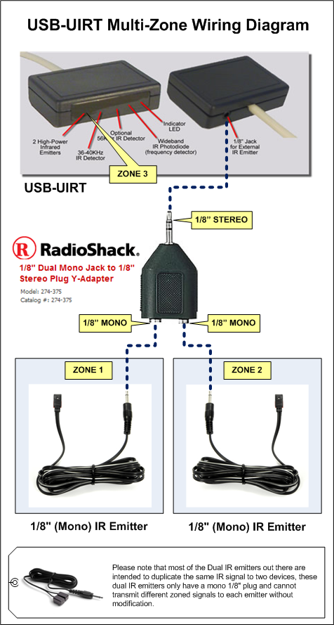

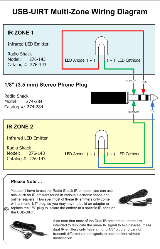

If you want to control three set top boxes in the future, Shadeblue posted two great diagrams. If the set top boxes have multichannel IR configuration, you can control more boxes than you'll ever want to rent!
Dave
File Type: png USB-UIRT Multi Zone Wiring Diagram2.png (199.0 KB, 269 views)
