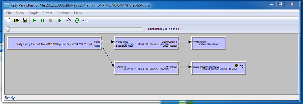

I'm also fighting an issue with some MP4 files not playing properly. I get a sage playback exception with error code -4,0x80040218 which I believe means that it couldn't find appropriate filters to play the file. Yet if I play the file in WMP it plays without issue. I've also found that if I change Sage to use the Sage Video Player instead of the DirectShow player then the problem video will work, but then other videos become problematic.
Not sure if you have any suggestions on that one? I have attached a copy of the relevent section of the log and a screenshot of my graph if that helps.
