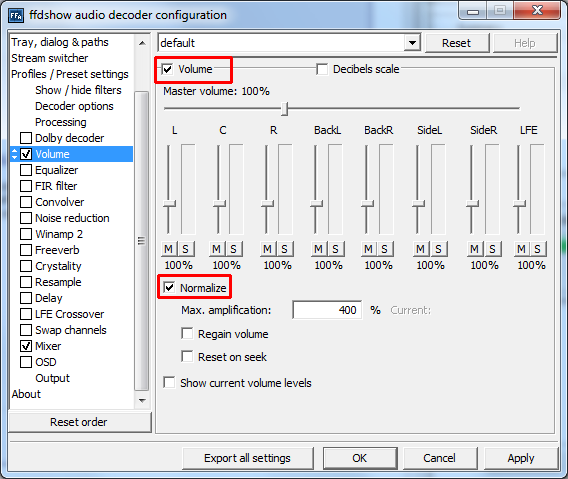

The biggest problem you're going to run into is whatever you try to apply is going to be applied to all audio streams so you will end up with HD audio being right and everything else being WAY TO LOUD.
That said, you could try making sure the Shark Codec pack is set to use ffdshow for audio and opening up the ffdsow audio config and setting the audio config to something similar to to have ffdshow normalize the volume which is what GJ recommended in the previous post. Might work, might not. This is moot if you are bitstreaming, but from the other post I think you said you are connecting from the computer straight to the TV? Of course if you are indeed connecting to your TV and using the TV's speakers, this begs the question why even bother with HD audio? It is going to be downconverted to stereo somewhere in the chain and that down conversion is going to make using the HD source a moot point. Not to mention that even the most discriminating ear will probably never notice the difference between an HD source and a DTS/AC3 source on TV speakers.... Just use the core DTS/AC3 track for blue rays and forgo the extra config with the HD stuff. Just my opinion though

I'm back to using Shark only now, but can't seem to get the output of 5.1 to be only 2 channel, even though I set it to 2.0 Stereo on the Audio tab for "Choose a speaker configuration". Playing in 5.1 makes the volume lower by spreading it out over 5 channels of course. I bumped the center speaker up on the Volume page of the ffdshow Audio Decoder Configuration screen and that helped. I also turned off the other two surround speakers by clicking the "M" under them. If I turned off the Center speaker I loose all voice. How do I tell Shark that I only have 2 speakers for output, when playing 5.1 content (Chuck, Medium, etc) Note that some HD shows only have 2 channels to begin with. Those are no problem, and play fine (House M.D.,etc.) I'll get this right yet.
