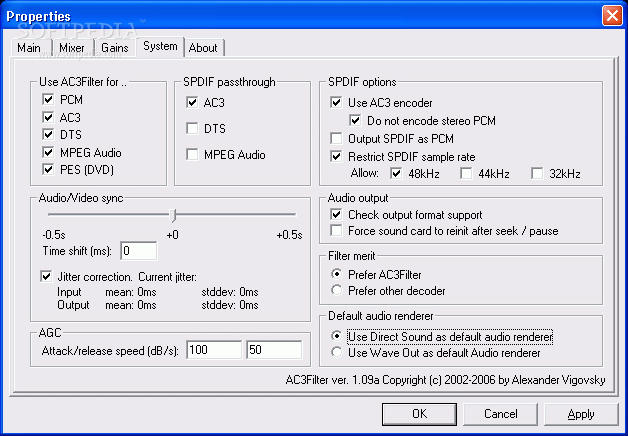

I'm betting you have the hardware in place, you just have to get the settings write in (Windows && (AC3Filter || ffdshow) && receiver) How's that for boolean logic! OK Screenshots shamelessly stolen from Softpedia because I don't have AC3 Filter installed on anything anymore. 1. Set your output to 5.1 or however AC3 labels it (3/2 or something maybe) 2. Check use SPDIF 3. During playback if you open the config you can see what the audio decoder chain looks like here. ![]() Make sure you have checks in the boxes you want to use AC3 Filter for and put checks in the AC3 and DTS checkboxes under SPDIF passthrough if your receiver can decode both. I can almost say with certainty it will do AC3, most will, but DTS is another matter. Things may look a tad different in your version, but the main points should still be there. |

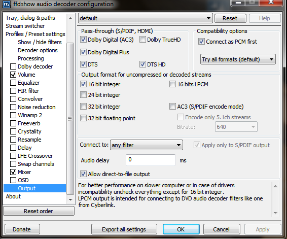

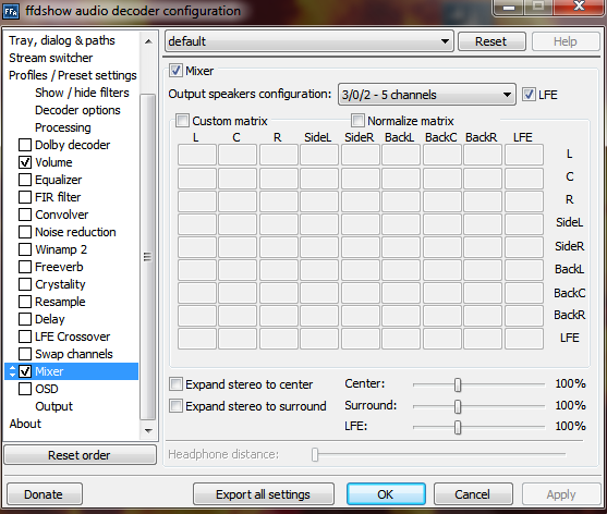

sdsean_happy = (screen_shoot_a && screen_shot_b) I'll let you all figure out whether or not that's true or false (i almost did some bitwise math, but i thought that'd be too geeky). OK anyway as for the update. 1.) You were right about ac3 filter, or at least partially. . . that solved my problem for Windows Media Player outputting 5.1, but not for SageTV 2.) So then I went into ffdshow audio config and did this. . . and and then I had to go into SageTV Detailed setup and force selection of AC3Filter for MPEG2 content and ffdshow for HD Audio content. But then. . . Most of the files that I have which are encoded as 5.1 (using the info from the details of a recording / import), sure enough once I did this started working. Surround sound goodness!! But of course the one I was testing with, recorded from ShowtimeHD (Inside the NFL), which says its 5.1, is only outputting Stereo, while others seem to be just fine. . . .not sure why this is. . . any hints there would be appreciated. I also seem to have a lot of recordings in Stereo (according to Sage), but I checked all my HD-PVRs, and they are all outputting 5.1. . . but hey at least I got somewhere. . . I very much dislike the fact that the "Real HD Audio Manager" is not doing this (allowing 5.1, etc). After all it is an "Audio Codec + Driver". Pretty freaking ridiculous. . . Does anyone know if I can toggle some settings in ffdshow / ac3 filter to have it toggle to 5/7 Channel stereo mode, when stereo data is encountered? Or at least to Dolby Pro Logic. . . ?

like i said, the fact that some say they are 5.1 when they are not doesn't bother me too much. . i only found one recording like this so far. .. i just need to figure out how I can get my stereo to switch to 5/7-channel stereo mode when a stereo signal comes in. . . I tried having ffdshow and ac3 filter set to "Expand stereo to center/surround" but that doesn't seem to have an effect. . .
