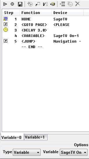

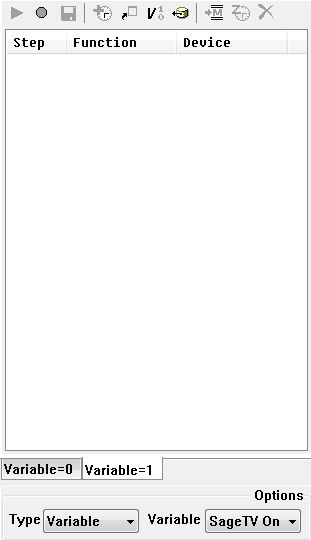

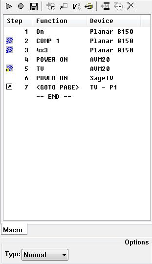

Here's what I've got (for my MX880).
For each of my devices I have a real "device" (in URC terms) with all the buttons for that device setup and working correctly, this is basically virtual copy of the real remote. I never actually use this (except for the rare debugging). Eg SageTV Then I create a activity "device" (eg TV), that is largely a copy of the device that's most interacted with (eg SageTV for TV) but includes other commonly used soft buttons, like Aspect Ratio toggle for the display. And of course I have stuff like volume and mute setup for punchthrough. Finally I have a launch page that's got the icons/soft buttons for the access to all my "activities" and then I "hide" the real devices on the second page. Each device has Power On and Power Off variable based macros (I make these separate from the "native" On and Off commands so I can debug things using the real On/Off commands if I need to without the macros making things difficult. Essentially the logic is: Code:
if <device on> == 0 Power On Command Delay until device accepts commands Set <device on> = 1 else do nothing On: Off: Then my "TV" launchpad (first Watch screen) has the following macro: I have similar macros for stuff like staring my Blu-ray player, Xbox 360, etc. All of which totally misses the point of your OP You'd have to look through the command list in Detailed setup, but I think there's a "Videos" command, but I'm not sure if it goes to the Videos list or the Media Library which would cause you to have to pick videos still. But yeah, you can always do the button push macros, which with RF should be pretty bulletproof.
