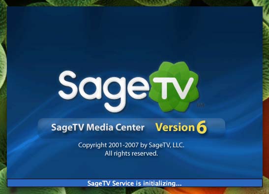

I too am having this problem, i just bought the mytv.pvr, i have it running in a Imac 24" with 2 gigs ram, with the eskapetv software it will detect and use the external usb device, but when trying to rung the sage program it wont even launch, i just get the launch screen and the message SageTV service is initilizing.
I have the myTV.PVR 29132 rev: d2a3
Should i just take it back and get my $99 back and buy a Eytv ?
My goal is to use it on my G4 800mhz plug it into that and use it to just record then watch from my laptop later on.
Jase
P.s this is all mac

And a screen shot.
Are you running MyTV/x 4.0.8 or 3.6.9? The 29xxx units need 3.6.9 currently, the 4.0.8 build is slightly broken.
