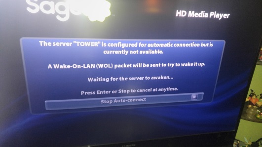

That said, if you start up the extender while the server is unavailable, it send a wake-up packet and wait for the server to become available, and once it is, it will connected to it, so you should be able to reboot your extender in the startup script, and once sage is up, the extender will connect.
