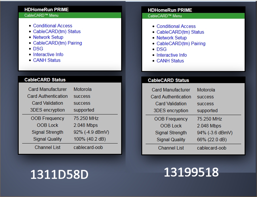

It always seems to happen on the same HDHR and always on one of the "premium" channels. (i.e. Bravo, Lifetime, etc.)
Do you think the HDHR could be failing? Are there any tests I can run on it?

I don't think there's anything particularly wrong with your HDHomeRun. This is an identified issue that was addressed in newer versions of OpenDCT and also with the internal remuxer SageTV uses. It's more likely a firmware bug.

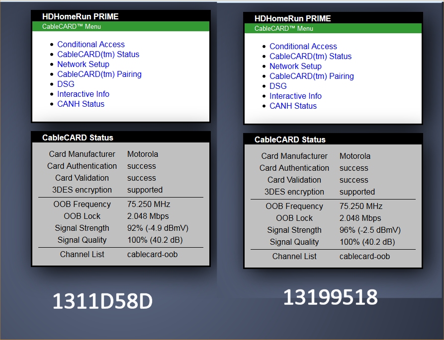

Happened again. It always seems to be a premium channel (Bravo, TNT, USA, etc.) and happen on the same HDHR tuner.
Since it is only once seems to happen once a week with only one show, I will wait until the new release is stable.

OK. Same problem.
I went back and checked, EVERY time it happened it was always the same HDHR 13199518.
I switched the LAN cable and the port, so I know it is not that. I am thinking it has to be the TV Cable, the HDHR, or the CableCard. The problem had NEVER happened on the other Prime.
I looked at the 518 HDHR log and there are lots of problems. But take a look at the image. The signal quality is only 66%. Both HDHR's from the same spliter, so I am guess maybe the cable or the spliter.

That's incredibly low. I would fix that.

I went out and brought a new coax cable. Take a look at the signal quality now.
I have a test running, recording 6 shows simultaneously and it appears to be running without any problems.
I want to thank you again for all of your help and support.
