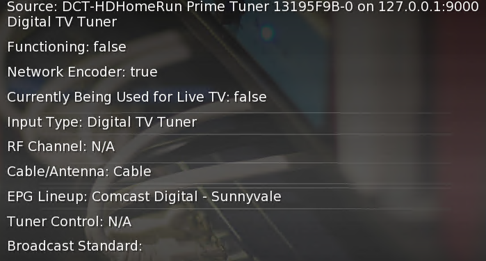

The log file is attached after turning off delayed OpenDCT service start and rebooting...
I have also attached what i see in SageTV

The log shows a very slight deviation from what I was thinking. The HDHomeRun interface has an APIPA address. The latest beta has some handling for those, but not at startup, so I'll take care of that. It might be another week before the next beta is released, but if you delay the service like you have, that should be a good workaround.
