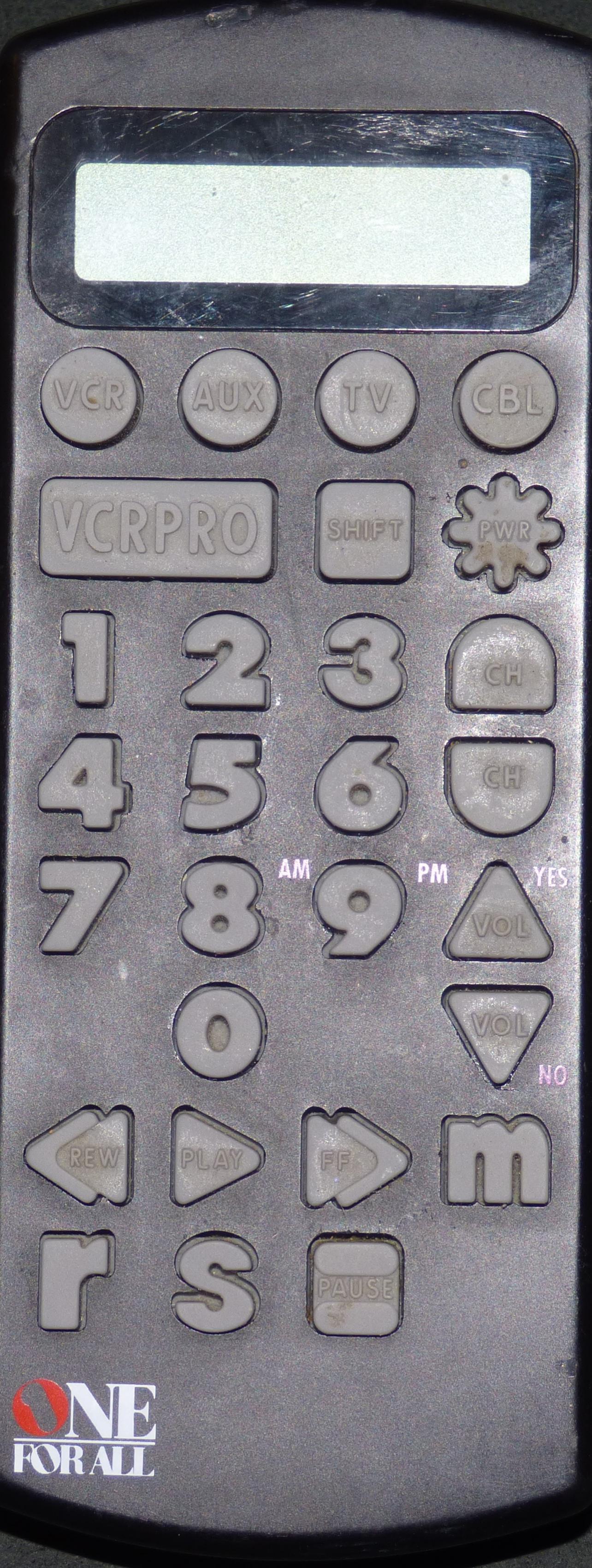

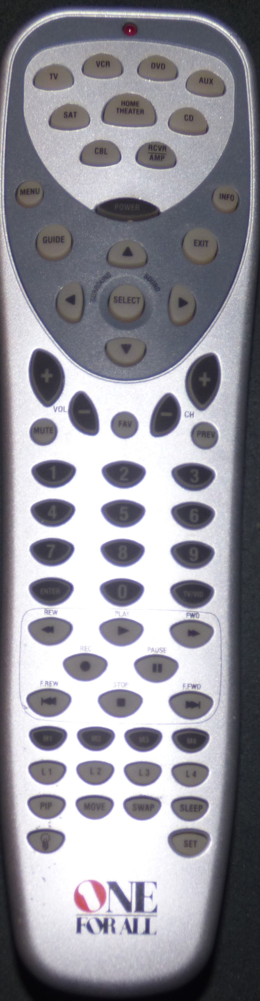

Here are my other URC remotes:
URC-6885 URC-8811B00 |
