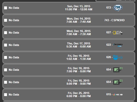

Server 1 (Time Warner): I just did a quick search for "no data" in the epg and it returned 1 program over the next 5 days that have no data.
Server 2 (Charter): I just did a quick search for "no data" in the epg and it returned 7 programs over the next 5 days that have no data.
This isn't a complete show stopper, but something is not quite right. Server 1 and Server 2 both share a problem with TBS on Friday Dec 18th with time slot 1:02am-1:30am, so hard to tell where that issue originates. Server 1 is, however, able to fetch data for the other 6 program slots that Server 2 is missing, which presents some strange issue.

Posts: 2,754
The 8th line item on the attached is normal.
