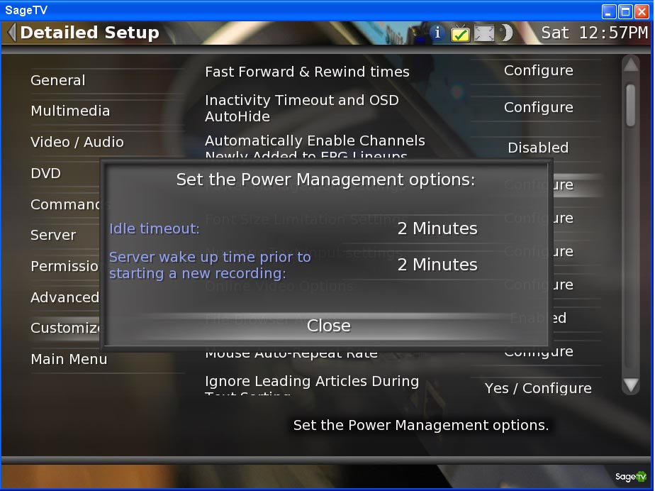

I recently decommissioned the domain controller for my LAN, of which my SageTV server was a member. In that earlier configuration the SageTV server would sleep when there was no activity, and wake itself up shortly before a recording had to be made. I mention this domain -> workgroup transition only because it's the most recent significant change I can recall making to the environment that the server operates in.
Now the SageTV server will not sleep. When I run powercfg -energy at a command prompt it reports that the SageTV executable has made a request that the system not be allowed to sleep. I don't know why this should be, but I suspect it's the immediate source of the problem. In researching online I've seen solutions to the same problem adopted by others, but they involve telling Windows to ignore the "don't sleep" requests from the SageTV executable. Since we often are watching Sage-recorded in other rooms via extenders I don't want the server to decide to go to sleep in the middle of a show. That would not be wife-friendly .Any thoughts on what I might try to diagnose or resolve this issue? - Diego Last edited by Diego Garcia; 08-08-2013 at 08:12 AM. Reason: marked as solved |

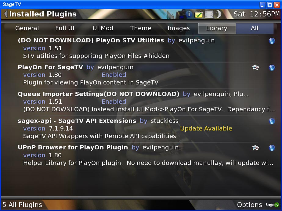

If you're comfortable doing so, can you post that HTML (of some modified equivalent text file).
Also, maybe type out a list of the plugins currently in use ...
Here you go.

I believe I've found the culprit: the PlayOn TV server.
I finally thought of checking out the system logs, and noticed the system >>was<< going to sleep. It was just waking itself up every 10 or 15 minutes. Since I have it configured to sleep after 10 minutes of inactivity, it was up most of the time, which is why I thought it wasn't sleeping. Turning off the PlayOn server seems to have solved the problem (24 hours and counting). You can find the events related to the PlayOn server in the Windows/application event folder. The server is named MediaMall. Thanks for all the help and advice! |
