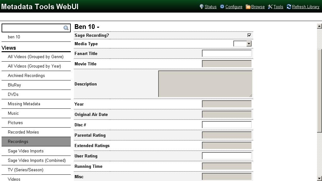

I cant brows recordings. It's empty. I can find them if i search for them.
If i search for ex "ben 10" i will find the recorded tv show and then i can search for metadata on thetvdb.com. Metadata is found and i click on the result "ben 10" from thetvdb.com. And where the metadata should be everything is blank instead (see attachment). Now everything is gone including "ExternalId"

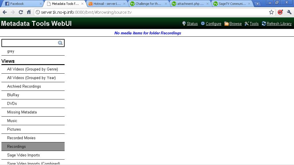

No I dont see any recordings (see attachment). I will find them if i search.
