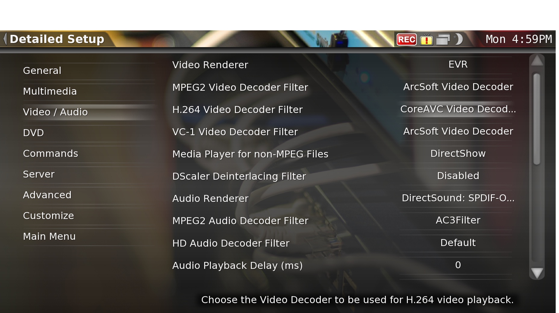

I installed the same one that came with my HD-PVR. I have a very new HD-PVR and the only driver / software it recognizes is the 1.5.7.0. The ArcSoft codec that came with it seems to play most everything MPEG and OTA just fine accept MKV's with header compression whereas I will switch it back to Microsoft DTV-DVD. The Sage code will work for me also, in most scenarios but will fail on certain AVI encoded files. ArcSoft just works for me. The football lockups alone were enough to send me screaming.
FFDShow would work but would have terrible interlacing. MS would work but would freeze entirely and randomly. Sometimes 10minutes, sometimes 90minutes into a program. After setting my STB (sorry for the STP above) to 720p and switching to ArcSoft I've yet to have a screen lock. I have had an occasional stutter but it appears to resolve itself better and keep going. If I back off the playback of live tv 10seconds I won't get any hiccups.
I'm assuming at this point it's a combination of my video card and codecs. Thou someone brought up that Sage's demux might have some issues as I've had this HTPC for sometime now using BeyondTV and never had any lockups like this previously. ArcSoft was very new to me, but I'm definitely not complaining about the results. WAF is much, much, much higher now and SageTV has now officially replaced BTV and Media Portal for me. Which makes me happy.
If you need something specific about the ArcSoft codec you'll have to help me by telling me how to determine the version as I just register the arcsoft.ax on the DVD.

I am running nvidia 8400gs, 2 gig of ram, Intel E6300 Windows 7, sagetv 7. I have smooth playback on clients. HD PVR. I don't believe you have a hardware issue. I would play with the codecs, also are you running any realtime virus scanning. Try the Coreavc codec.

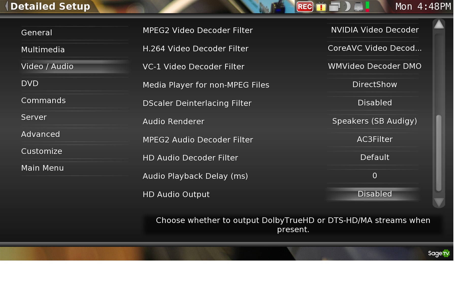

during setup, did you run through the video card tests?
Also, if you are displeased with sage's codecs, it is very easy to switch to Microsoft's. If at that time, playback is still unsatisfactory, my limited opinion would be that the problem is not related to sage.
While you seem adverse to trying many combinations, you seem to have already done a multitude of testing.
I for one would never use the coreavc codec. There are plenty of free alternatives. And if the video plays fine in other players, the codec is already sufficient. Just switch your video renderer to microsoft and it will use the same one media player uses.

See attached, my current video configurations for my 3 pc clients. I have excellent playback, no stutter. I am not saying that this configuration will work for you. This is windows 7, but one of these clients was a year old running xp,with same codecs until I upgraded it to windows 7 in October. One client running windows 7 since december. Newest PC client built in October with window 7. I am running 4gig of ram on one pc client. See signature for client specs.
I used the coreavc codec because it was cheaped and designed for use with nvidia graphics cards. It a 9.95 codec. I have Nvidia Purevideo gold codec 29.95, Elecard codec, and Powerdvd 9. I have bought all of these over the years. Powerdvd 9 is for blueray playback. Tried free ones to.
This is a hobby for me and I like to tinker with it. Are you sure the sagetv codec is the best one for the job. It may be the 4 cylinder just to get you going when you need a v8. Just my opinion.
I do not use the server for playback.
From experience-poor quality OTA air signal used to cause my server to reboot when it doubled as a client, the main reason I separated it from playback duty. Corrupt signal will cause all kinds of problems. Resolved problem by amplifying signal to get it above 90% on my 1250 and 2250s.(1). Removed any channels that could not maintain a signal with amplification at 90%. (2) Server no longer used for playback, just capture. I use directv through svideo and component, never seen an issue with playback. I have seen post that some problems are caused by the cable provider being used and there stb.
