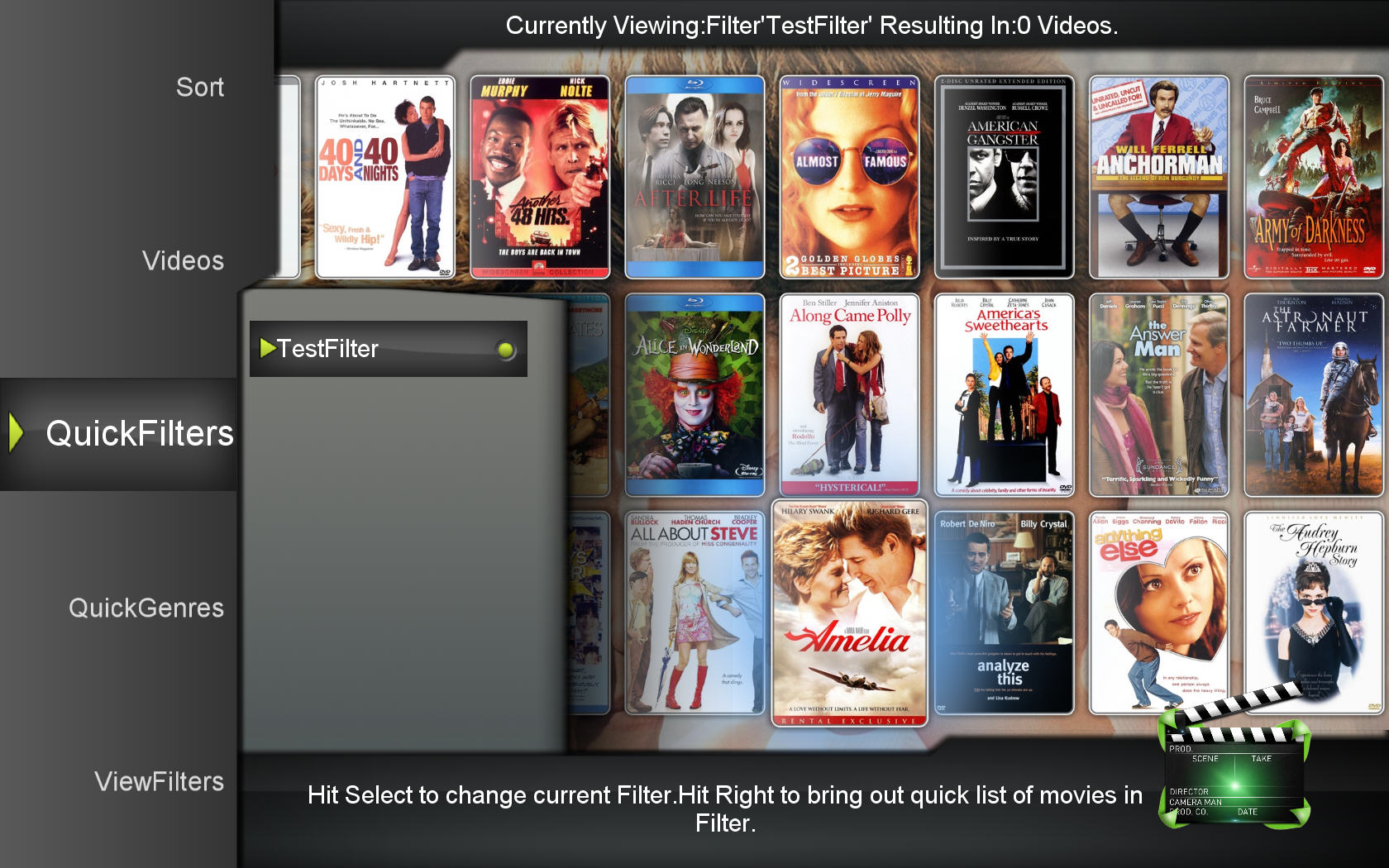

I setup a "TestFilter" category in MyMovies - then I added two movies to it.. Then in Sage My Movies - I went into options and tried to select it under the "QuickFilters" menu option in the options menu. I have two issues here: 1. When I select "TestFilter" that is shown there now - it changes the title of the page - but the results are 0 Videos. - See attached "snap034.jpg" 2. A navigation bug in the options menu. I scroll down to QuickFilters - press the right arrow - and the menu comes up - but if I hit the right arrow one more time - the selection menu with "TestFilter" goes away and it will not come back unless I quick out of the options area all together and then go back in. This may be due to the fact that there are no videos coming up for some reason with this QuickFilter. If its supposed to act like it does with Genre's - which pulls up the list of movies for the selected genre - this could be why it doesn't work - a bug when there are 0 videos found to list maybe? I originally added just my "Feature Films" into my movies - but now I'm looking to expand that to some of my other collections and I need to be able to keep them separate and organize them with Custom Views.. It's going to take me some work to get the next set of disks/videos into my movies because they are some rare disks / collections that are not going to be in my movies database, so I would like to keep them separate using categories/filters untl I can get the info updated and correct/complete. I've tried rescanning my collection from the detail setup -> Advanced -> Rescan Now - area. - but no luck - it still wont pull up the two test videos I've set to this "category" in my movies. Thanks! If you need anymore info let me know! - D2G Last edited by d2globalinc; 09-30-2010 at 11:56 AM. Reason: SOLVED |

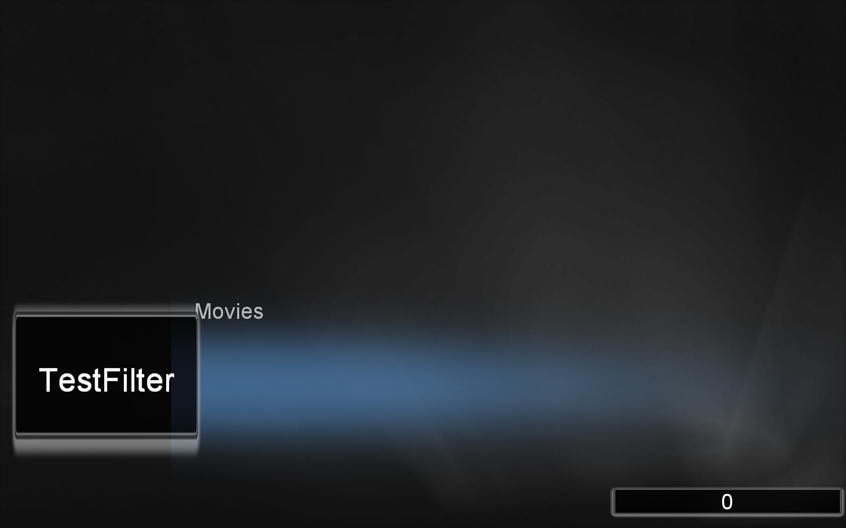

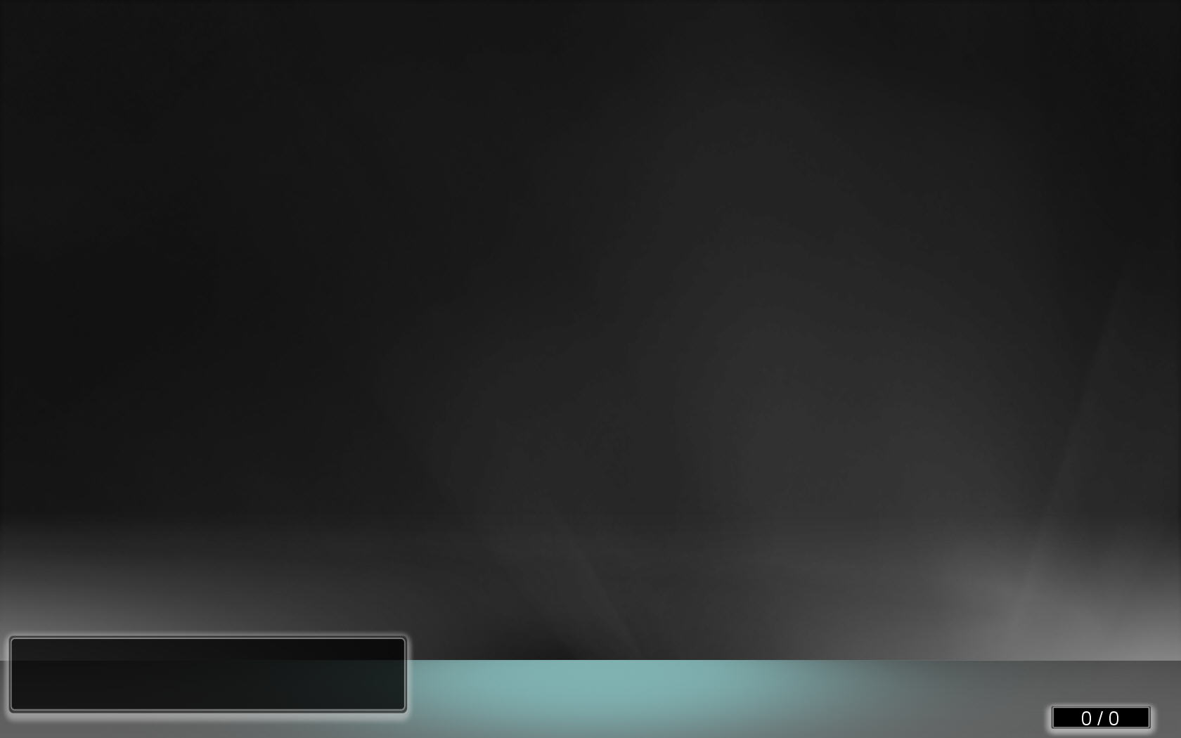

Noda - Looks like it also has 0 listed, and when going into it - it pulls up blank.
Snapped more pics - went to videos -> my movies -> Filters - D2G |

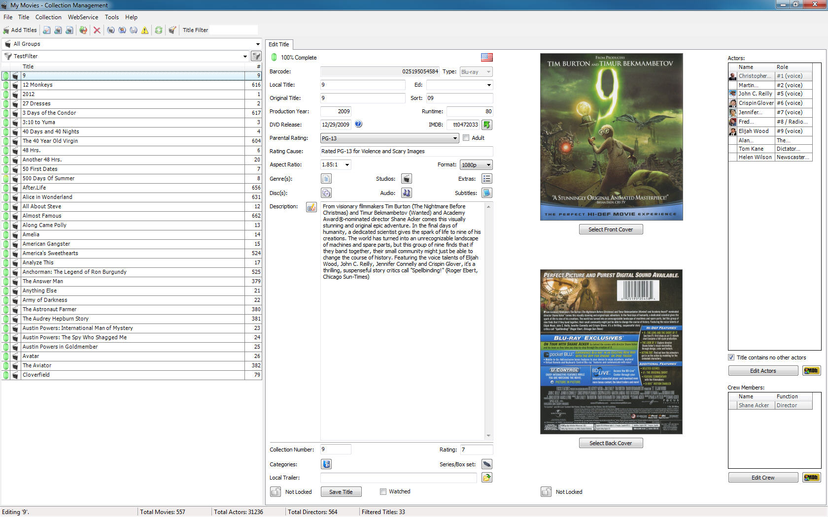

So I had more videos to work with - I added a bunch more to the "TestFilter" category in My Movies Collection Management..
Attached Screenshot of the videos coming up with the search filter - so its showing them in that query. - D2G |
