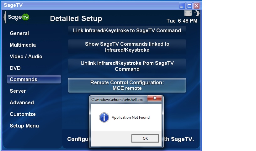

I've been down the first road but I went down it again. Now the u/d/l/r arrow keys are giving double presses 80-90% of the time. Whenever I hit the green button I here a beep and see a quick flash in the middle of the screen that is the result of a text box popping up in the background. The good news is that the green button now takes me back to the home screen, but I get a beep and a new text box every time.
As a side note the remote still provides input to Sage when the remote config is set to none/external just no functionality from green button (other than the message box), Recorded TV, Live TV, or DVD Menu buttons. Still get double presses on arrow keys too.
I had already disabled the sleep button on the remote. Nothing like in-inadvertently pressing it and having to get up to turn the system back on!

Did you link any of the buttons on the remote to the Sage commands? The remote itself uses the same messages as the arrow keys on a remote. The arrow keys shouldn't need to be linked in Sage. The defaults should have just worked. You can unlink them in the Sage Detailed Settings-Commands menu.
I had not linked anything to the remote but for giggles I tried unlinking the arrow buttons on the remote. That resulted in the u/d/l/r remote buttons not working at all and neither did the arrow keys on the keyboard. It's almost like Windows is intercepting the remote codes and handing sage the remote code AND the corresponding button press. ie if up is pressed on the remote, sage ends up seeing the up remote code along with an up arrow keyboard code. I don't have anything to back this up though and can't think of a way to test it...
