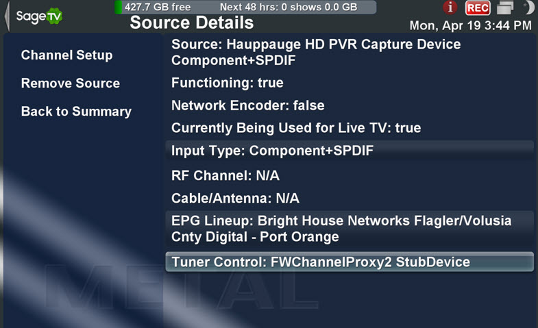

Unlike exemultituner.dll, fwchannelproxy.dll never shows up as an option in video source setup -- it is like SageTV does not see the dll as a tuner interface.
Here is what happens with exemultituner:
Originally Posted by MeInMaui View Post
After setting up the encoder to use the ExeMultiTuner plugin in the SageTV source setup, did you go into sage.properties and add the panel number for that STB (looks like 2 in your case) to the mmc/encoders/.../device_name property? (make sure you shut down SageTV first or the changes won't take.
BTW: you should be able to do this from the Source Details screen: select Tuner Control, Change Tuning Device, then choose from the list. If it isn't there, then something isn't configured properly.
Old 04-19-2010, 01:53 PM
robk's Avatar
robk robk is offline
Posts: 283
It shows up for me. You lost me a day or two ago with the discussion of graphs - I never touched that stuff. But, the FWProxy works well - I wish I could step you through it, but the discussion is getting beyond my abilities! See attachment.
Rob

Old 04-19-2010, 03:17 PM
robk's Avatar
Posts: 283
When I look at the "Common" folder, RemoteCodes, I see 3 folders: ACTiSYSIR200L, FWChannelProxy2, USB-UIRT Transceiver.
In the FWChannelProxy2 folder is a file "StubDevice.ir" that opens to this:
StubDevice 38000 400 4 600 800
So, it looks to me like Sage regards FW tuning as a type of IR tuning, just having the signal redirected from the blaster to the FW port (in the correct format of course).
I think that is the only place Sage could pick up the entry in the "Tuning Control" of FWChannelProxy2 StubDevice
Make any sense?
Rob
Old 04-19-2010, 03:45 PM
sflamm sflamm is offline
Join Date: Mar 2009
Posts: 1,653
It does. And I noticed there was a "Stubdevice.ir" before... but the contents were empty.
I figured that FWChannelProxy somehow created it... or it was somehow a consequence of my manually configuring the sagetv.properties (since FWChannelProperty was not a choice when I configured the video source).
Not sure how you would use this file... And how does the name "Stubdevice" work... is the "device_name=Stubdevice" in your sagetv.properties?
Old 04-19-2010, 04:44 PM
robk's Avatar
Posts: 283
Yup,
Here's a piece of properties:
mmc/encoders/-431556906/90/0/available_channels=
mmc/encoders/-431556906/90/0/brightness=134
mmc/encoders/-431556906/90/0/contrast=128
mmc/encoders/-431556906/90/0/device_name=StubDevice
mmc/encoders/-431556906/90/0/hue=128
mmc/encoders/-431556906/90/0/last_channel=1372
mmc/encoders/-431556906/90/0/provider_id=1221190196469
mmc/encoders/-431556906/90/0/saturation=128
mmc/encoders/-431556906/90/0/sharpness=128
mmc/encoders/-431556906/90/0/tuning_mode=
mmc/encoders/-431556906/90/0/tuning_plugin=C\:\\Program Files\\SageTV\\Common\\FWChannelProxy2.dll
mmc/encoders/-431556906/90/0/tuning_plugin_port=0
mmc/encoders/-431556906/90/0/video_crossbar_index=0
mmc/encoders/-431556906/90/0/video_crossbar_type=90
Don't quite understand it, but it works. I find Sage to be a bit like that - sort of "wow, I got it doing what I want it to do, I better leave it alone" But, that's only because I don't need another career, just want to watch TV :>
Rob
Old 04-19-2010, 04:54 PM
Join Date: Mar 2009
Posts: 1,653
ah ha!
The trick is here:
This is what SageTV uses to connect the sagetv.properties to the .ir file.
I believe it looks for a folder under the name of the "tuning_plugin" and opens the .ir file that matches "device_name".ir and uses its parameters. The 1st field in the .ir file needs to match the device_name.
For example:
tuning_plugin is "FWChannelProxy2.dll
the device_name is "StubDevice"
folder name is "FWChannelProxy2" in SageTV/common
the .ir filename is StubDevice.ir
the .ir file of interest has the key entry called "StubDevice"
In the case of EXEMultituner:
tuning_plugin is "EXEMultituner.dll
the device_name is "2"
folder name is "EXEMultituner" in SageTV/common
the .ir filename is 2.ir
the .ir file of interest has the key entry called "2"
I think this makes some sense?
I dont believe that I put the StubDevice entry in the sagetv.properties or added the right .ir entries when I configured it manually... I'm wondering if I manually put these in if it will work....
