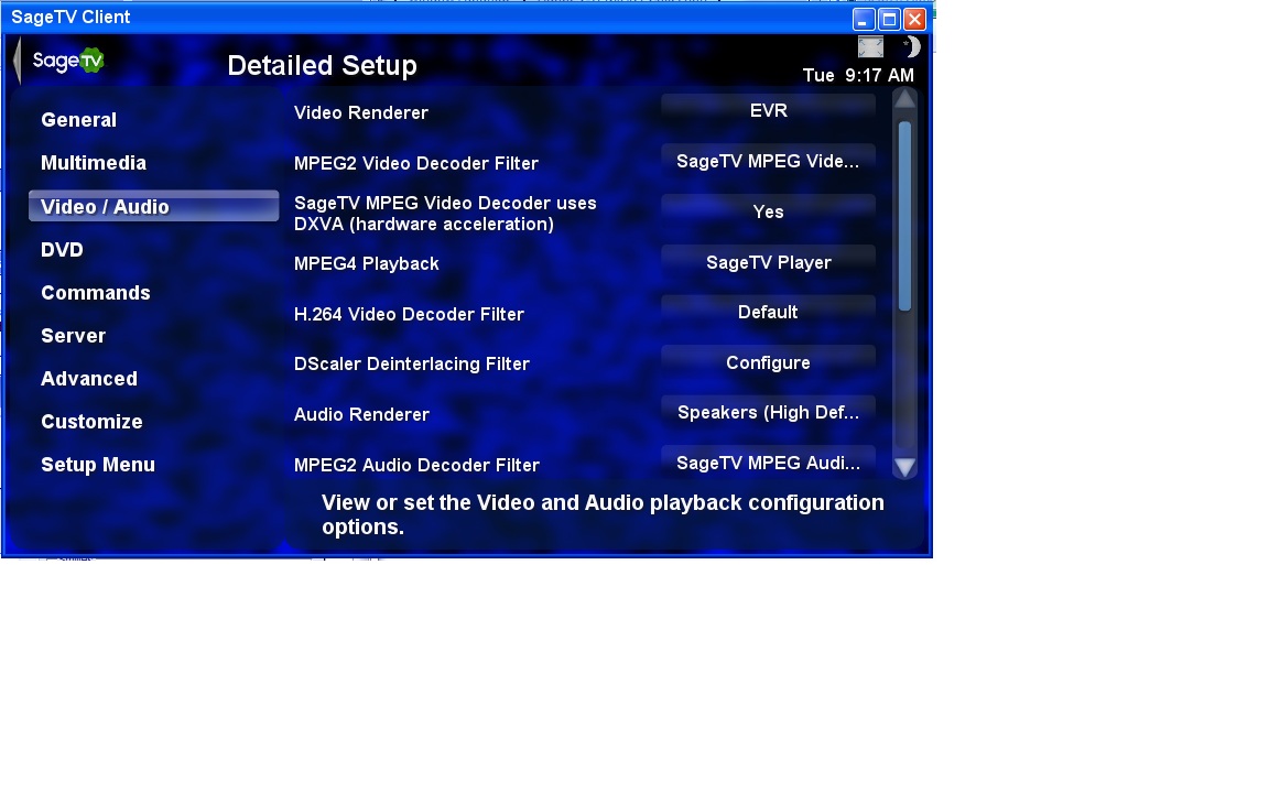

I have migrated to Windows 7 x64. One of the nice things I was looking forward to is native AVCHD (HD camcorder) and native advanced HD codec support for VC1 / H.264 etc...and I seem to have gotten what was promised as wmplayer plays back all my .mts files (HD Cam) and .mkv files (blu-rips) flawlesssly. However, I can't figure out how to make SageTV use these new features. SageTV gives me an error when I try to play either of these file types on my PC...what settings to I need to configure in Sage so that it uses the correct codecs for these file types. Below is a screen grab of the current config... mv |

I am successfully using PowerDVD 8. So successfully in fact that I can now stream HD to my old MVPs. Once you've installed your preferred codec you need to go into Detailed Setup/Video-Audio and change the H.264 Video Decoder Filter to select it. If you don't have that parameter then you need to upgrade because it only appeared in more recent releases of Sage. Good luck. |
