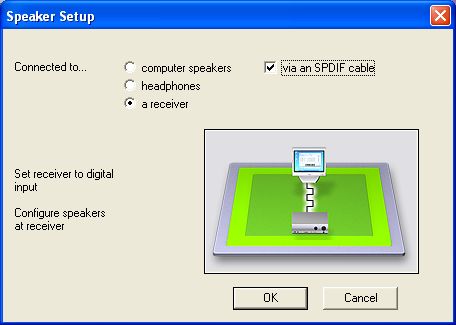

As for audio:
You MUST set it to S/PDIF output for DVDs, these decoders will not decode DVD audio outside Dolby Certified applications (WMP, MCE, and TT I believe right now).
You have to go into the audio settings, Speaker Setup, select "a reciever" for the "Connected to..." and then check the box "via an S/PDIF cable"
See below

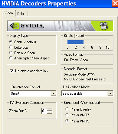

Stanger:
So are you saying that what you will see this "Software Mode YUY2" in the properties EVEN if you have Hardware Decoding (as in my case)? I read through the entire thread but maybe I missed something in the translation.
I have attached the below file from my sage machine; the picture is pretty awesome so I am not complaining; but like everyone else here I want to get the most bang for my hard earned buck LOL..

Sort of, if you throw the VPP (or any other post processing filter), it it kicks the decoder out of DXVA mode (hence the Software Mode decoder format).

  #73
Old 12-24-2004, 11:33 AM
stanger89's Avatar
stanger89 stanger89 is offline
Location: Marion, IA
Posts: 15,188
If you want it in hardware mode, don't use the "NVidia Video Post Processor" filter. In Sage pick "NVidia Video Decoder" (or "Default" if nV is default).

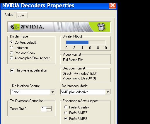

Intereesting to note, I finally changed from Nvidia Post Processor Decoder to Default and I WAS finally able to see the proper settings in the Nvidia Decoder and I could finally set the pixel adaptive mode and man o man did it make a big difference; and I thought that VPP was the way to go...to me the Nvidia Decoder option was superior...From my point of view using the Nvidia Decoder Option vs the DEFAULT Option was not as good until I could set the "Per Pixel Adaptive" mode in the decoder properties panel...
-Dan

Originally Posted by tealcomp
Intereesting to note, I changed from Nvidia Decoder to Default and I WAS finally able to see the proper settings in the Nvidia Decoder and I could finally set the pixel adaptive mode and man o man did it make a big difference; and I thought that VPP was the way to go...to me the Nvidia Decoder option was superior...
-Dan
The VPP is really for film content (DVD's). Using the decoder with DXVA will generally alwasy be better for video content (TV recordings).
  #79

Actually you're both right, sort of.
Tealcomp, you are using the VPP still, or I suppose it's more correct to say you're still using the functionality of the VPP. Your 6800, when in DXVA mode, with Smart deinterlace control selected, performs the film detection in hardware.
DXVA mode on my 6800 is the only way I run. You should watch that screen sometime when you're playing a Sage recording, even though it's recorded as video, the decoder will correctly detect much of the recording as film, and it will switch backa nd forth, rather interesting. Reminds me of Dscaler
