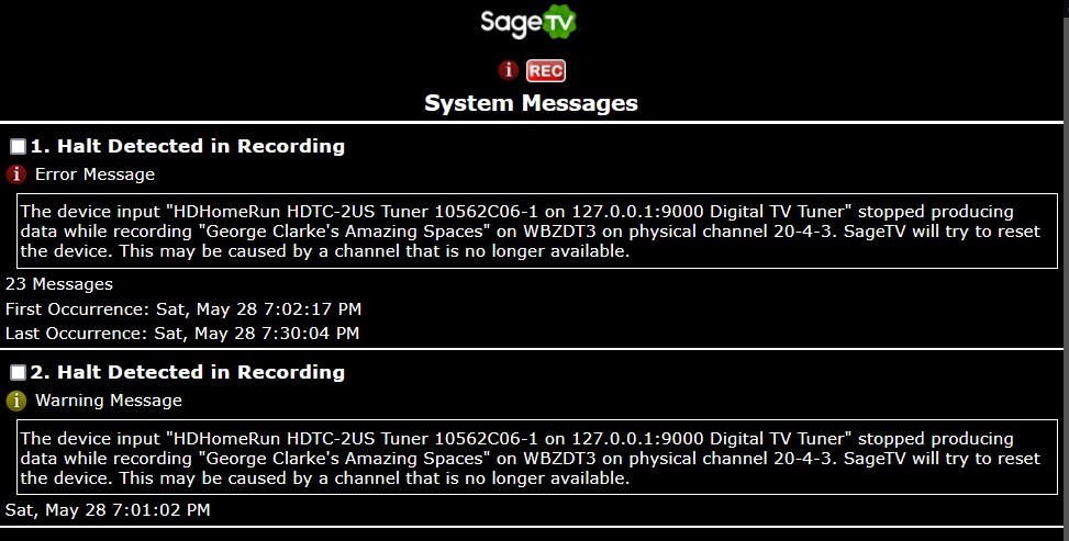

I have a HDhomerun Prime (cable 3 tuner) and a HD Extend (OTA 2 tuner).
I have been getting a LOT of errors like the attached picture shows whenever i try to record a show. This recently started happening. It was working fine for a long time before that. The EXTEND tuners work OK when i record shows using Jellyfin or watch them directly using the HDHomerun app. Biut SageTV is having problems - so many that i cannot record any more shows using the Extend. Any idea what is happening? I've rebooted many times. This is on Windows 10. I thought maybe OpenDCT was having issues but it works fine with the HDHomerunPrime tuners.

No, the tuner works fine with 100% signal strength when not accessing using SageTV. This is an OTA tuner, not cable. I am able to record shows using it with other PVR software like JellyFin no problem.
But it's now become intermittent with SagetV. I am wondering of it's a OPENDCT issue. I've attached the log file and see errors in it.
- James M - Capture Devices: HDHomerunXTEND, HDHomerunPrime Last edited by brandypuff; 05-28-2022 at 07:21 PM. |

I don't have an HDHR Extend, so I don't have a log file to compare with, but it seems to be trying to tune channel 22-68-5 and then claims it doesn't have a program on the lineup. Does this occur when you try and record any Extend tuner channel? The log does mention something about a remap: INFO ChannelLineup - '22-68-5' was remapped to '68.5'. Might want to have a read through your old thread here (if you haven't already): https://forums.sagetv.com/forums/showthread.php?t=64584 as it does reveal some information on a couple different ways to configure the Extend, and you could re-check your settings (and file extension). |

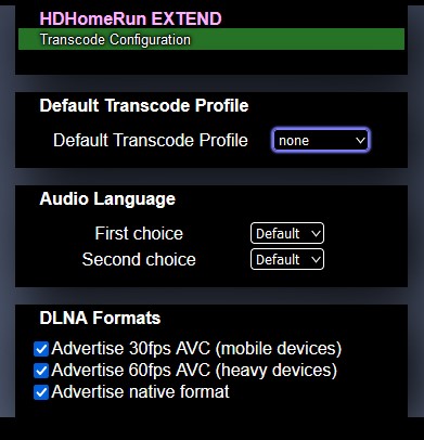

I'm just guessing here because I don't have screenshots of your available tuner list in SageTV (where the user adds new tuners), but is it possible that you set the extend to 'not transcode,' or whatever setting that is on the Extend itself (I'm reading in the other thread that I linked to), and there was a firmware update to the Extend that changed it back to transcoding which SageTV can't handle natively. Is there a way to access the Extend tuner directly and adjust the transcoding setting, or shut if off entirely?
I see SiliconDust removed "SageTV" from the BCA compatibility mode list from the EXTEND tuner. I don't know what this does but it used to be there and other PVR software is listed like Enby, Windows Media Center, Next PVR, etc.
Also, the EXTEND is set to not transcode. See attached. I seem to remember that this broke recently after a firmware update to the EXTEND.

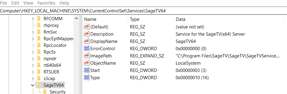

The Problem is the 64 BIT version change what the HDHomerun is looking for ... This is ehere the HDHomeRun looks for sagetv HDHomeRun Setup is looking for: HKEY_LOCAL_MACHINE\SYSTEM\CurrentControlSet\Services\SageTV\
Notice it change From SageTV to SageTV64 ... I gave nickk the info.

OpenDCT x64. Not exactly sure why it started working but i know i did the following: 1. It requires OpenDCt to work 2. in the SageTV source configuration, "Cable/Antenna: Antenna" should be set for each of the the EXTEND tuners 3. in Sage.Properties, encode_digital_tv_as_program_stream=false for each EXTEND Tuners so .ts files are written. 4. Default Transcode Profile for the Extend Antenna tuners should be set to "none" for the Extend OTA tuner (http://{EXTENDtunerIP}/transcode.html I believe i had these settings before and it didn't work so i don't know.
