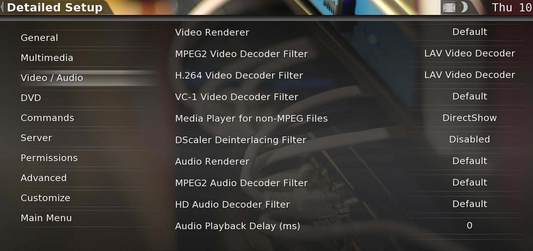

Here you go ! Thanks for the help!

I might suggest setting the audio and video codecs explicitly instead letting them go to default. set the VC-1 to LAV Video. set the MPEG-2 audio to LAV Audio. set the HD audio to LAV audio. I am presuming the HD Audio is turned on (it doesn't show in the picture). It maybe also be helpful to: set Video Renderer to EVR. The Audio Render - you should at least look at what is available. I use 2 Intel NUCs, one for the server and one for a client. It may be that some adjustments will be needed in the LAV filters settings (I think it might be the LAV Video but I will need to look when I get home). Sometimes the default settings are fine and other times they need some tweaking. And there maybe other changes, like using the LAV Splitter instead of the Sage Splitter. But try some of the above before going down that road (I couldn't get MKV files to play if I was using the Sage Splitter)

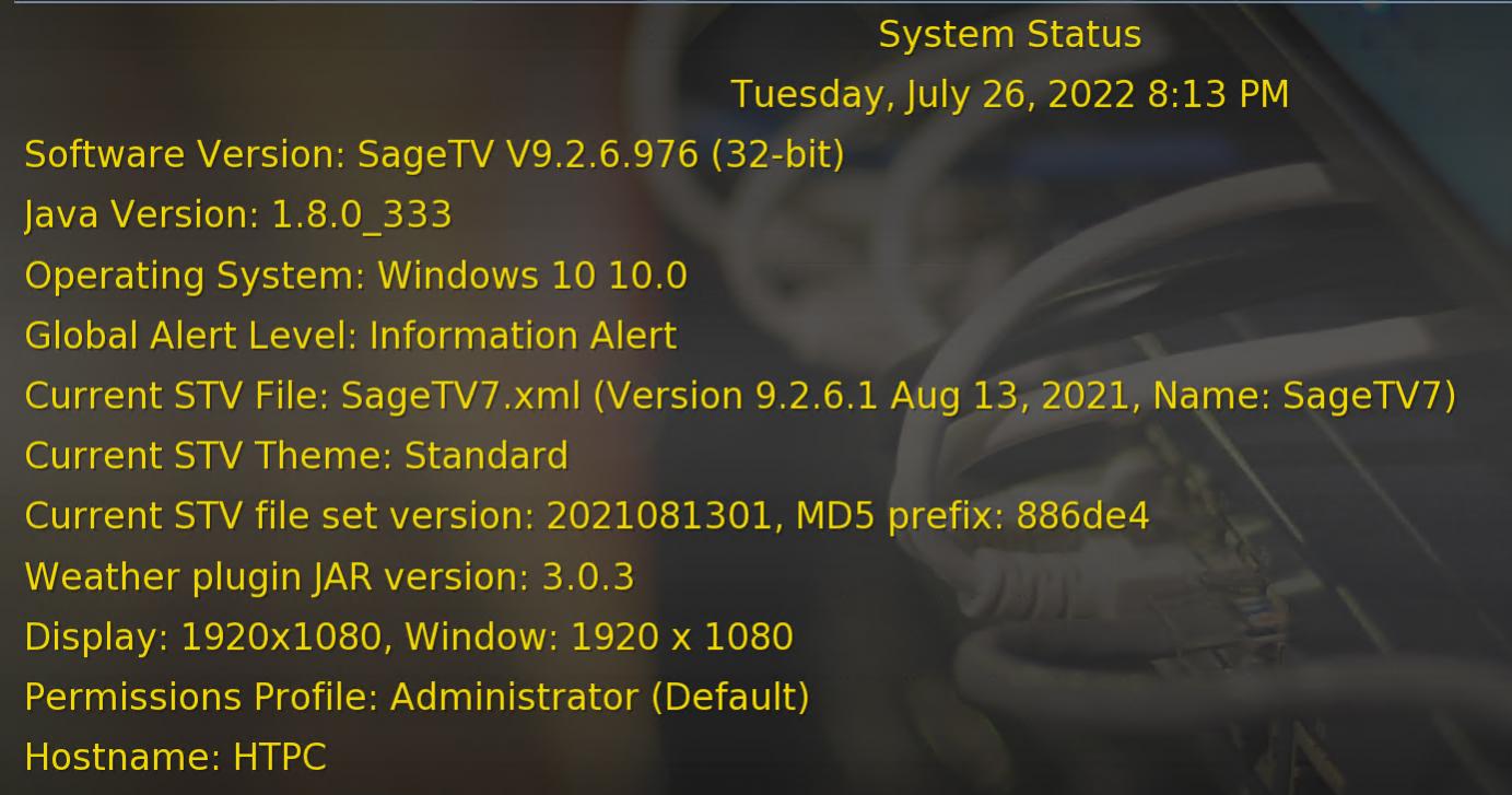

OS Windows 10 Pro 64-bit, latest install of SageTV Windows Processor 12th Gen Intel(R) Core(TM) i7-12700K, 3600 Mhz, 12 Core(s), 20 Logical Processor(s) with a Intel UHD GRAPHICS 770 included on the CPU 2 HDHomeRun Prime with cable cards see attached for SageTV SYS info Also how do I find out what is behind each of the Default items under Video/Audio settings any help would be appreciated Thanks Scat

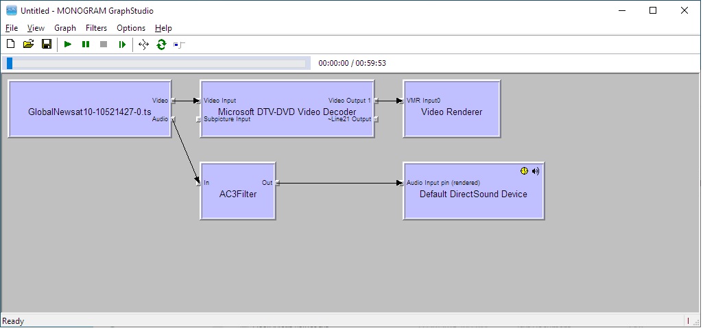

Google for a tool called Graph Studio. When you render a video file with Graph Studio it will tell you what decoder and renderers are being used. Whatever comes up should be the same defaults that Sage is using.

Below is the bottom section of that log file. I wanted to add log file but must be to big. How do I fix this or turn off the Weather plug-in? Thanks Scat un 7/31 12:52:28.988 [FinalRender-SAGETV_PROCESS_LOCAL_UI@1287aab] ImageUtils loading URL http://icons.wxug.com/i/c/c/NA.gif Sun 7/31 12:52:28.991 [Seeker@8843ac] Enforcing keep at most limits for the files... Sun 7/31 12:52:28.992 [Seeker@8843ac] DONE enforcing keep at most limits for the files. Sun 7/31 12:52:28.992 [Seeker@8843ac] Seeker clearing unwanted and partial files... Sun 7/31 12:52:28.993 [Seeker@8843ac] DONE clearing unwanted and partial files. Sun 7/31 12:52:28.996 [Seeker@8843ac] needFreeSize = 4.05 GB currFreeSize=3657.555545088 GB Sun 7/31 12:52:28.996 [Seeker@8843ac] needFreeSize = 2.025 GB currFreeSize=3656.686500864 GB Sun 7/31 12:52:28.997 [Seeker@8843ac] Seeker waiting for 2 mins. Sun 7/31 12:52:29.057 [FinalRender-SAGETV_PROCESS_LOCAL_UI@1287aab] ImageUtils creating BI copy sun.awt.image.ToolkitImage@8f1ea7 w=-1 h=-1 freeMem=289189136 totalMem=591224832 Sun 7/31 12:52:29.057 [FinalRender-SAGETV_PROCESS_LOCAL_UI@1287aab] ImageUtils loading file C:\Program Files (x86)\SageTV\SageTV\STVs\SageTV7\Themes\Standard\HeaderWeatherRightBG.png Sun 7/31 12:52:29.058 [FinalRender-SAGETV_PROCESS_LOCAL_UI@1287aab] ImageUtils creating BI copy sun.awt.image.ToolkitImage@16775a6 w=160 h=18 freeMem=289189136 totalMem=591224832 Sun 7/31 12:52:29.058 [FinalRender-SAGETV_PROCESS_LOCAL_UI@1287aab] ImageUtils creating scaled masked copy width=320 height=36 option=null BufferedImage@c7986c: type = 2 DirectColorModel: rmask=ff0000 gmask=ff00 bmask=ff amask=ff000000 IntegerInterleavedRaster: width = 160 height = 18 #Bands = 4 xOff = 0 yOff = 0 dataOffset[0] 0 Sun 7/31 12:52:29.979 [Fork-OPUS4-108092@171debe] Updating weather Sun 7/31 12:52:29.982 [Fork-BASE-71232@7e7db5] EXCEPTION in getValueAsObject:sage.jep.ParseException: Invalid parameter type for:Round( Temp * 1 ) Sun 7/31 12:52:30.710 [Fork-OPUS4-111999@149e866] ENDING background video thumb preloader thread, ID = 0.7901624795946772 Sun 7/31 12:52:34.974 [main@1eba861] Screen pos= 1768, 979 Sun 7/31 12:52:35.026 [AWT-EventQueue-0@18e6db6] winAdjustForAutoHide - Taskbar is auto hide Sun 7/31 12:52:36.408 [AWT-EventQueue-0@18e6db6] Sage.exit() called. Sun 7/31 12:52:36.409 [AWT-EventQueue-0@18e6db6] Stopping all core plugins Sun 7/31 12:52:36.409 [AWT-EventQueue-0@18e6db6] Calling stop on plugin: Commercial Detector Sun 7/31 12:52:36.410 [AWT-EventQueue-0@18e6db6] CD: ComskipJob.stop: Stopping ComskipJob. Sun 7/31 12:52:36.410 [AWT-EventQueue-0@18e6db6] CD: ComskipJob.stop: Stopping ComskipJob. Sun 7/31 12:52:36.411 [AWT-EventQueue-0@18e6db6] Destroying all core plugins Sun 7/31 12:52:36.411 [AWT-EventQueue-0@18e6db6] Calling destroy on plugin: Commercial Detector Sun 7/31 12:52:36.412 [AWT-EventQueue-0@18e6db6] CD: ComskipJob.stop: Stopping ComskipJob. Sun 7/31 12:52:36.412 [AWT-EventQueue-0@18e6db6] CD: ComskipJob.stop: Stopping ComskipJob. Sun 7/31 12:52:36.413 [AWT-EventQueue-0@18e6db6] Cleaning up servers Sun 7/31 12:52:36.414 [SageTVMiniDiscoveryServer@1d2adae] Error w/SageTV client connection:java.net.SocketException: socket closed Sun 7/31 12:52:36.414 [MiniMVP@1971fc2] MiniError-1:java.net.SocketException: socket closed Sun 7/31 12:52:36.415 [MiniBootp@5ea9b2] MiniError-3:java.net.SocketException: socket closed Sun 7/31 12:52:36.415 [MiniTftp@1216203] MiniError-2:java.net.SocketException: socket closed Sun 7/31 12:52:37.320 [AWTThreadWatcher-SAGETV_PROCESS_LOCAL_UI@12ce57b] EventThread-SAGETV_PROCESS_LOCAL_UI Hang Detected - hang time = 763 UILocker=null Sun 7/31 12:52:38.085 [AWTThreadWatcher-SAGETV_PROCESS_LOCAL_UI@12ce57b] EventThread-SAGETV_PROCESS_LOCAL_UI Hang Detected - hang time = 1529 UILocker=null Sun 7/31 12:52:38.848 [AWTThreadWatcher-SAGETV_PROCESS_LOCAL_UI@12ce57b] EventThread-SAGETV_PROCESS_LOCAL_UI Hang Detected - hang time = 2292 UILocker=null Sun 7/31 12:52:39.611 [AWTThreadWatcher-SAGETV_PROCESS_LOCAL_UI@12ce57b] EventThread-SAGETV_PROCESS_LOCAL_UI Hang Detected - hang time = 3055 UILocker=null Sun 7/31 12:52:40.374 [AWTThreadWatcher-SAGETV_PROCESS_LOCAL_UI@12ce57b] EventThread-SAGETV_PROCESS_LOCAL_UI Hang Detected - hang time = 3818 UILocker=null Sun 7/31 12:52:41.136 [AWTThreadWatcher-SAGETV_PROCESS_LOCAL_UI@12ce57b] EventThread-SAGETV_PROCESS_LOCAL_UI Hang Detected - hang time = 4580 UILocker=null Sun 7/31 12:52:41.416 [AWT-EventQueue-0@18e6db6] Cleaning up PM Sun 7/31 12:52:41.418 [AWT-EventQueue-0@18e6db6] Killed Carny. Sun 7/31 12:52:41.419 [AWT-EventQueue-0@18e6db6] Killed Scheduler. Sun 7/31 12:52:41.420 [AWT-EventQueue-0@18e6db6] Seeker.finishWatch(UIManager:localhost@@SAGETV_PROCESS_LOCAL_UI-4af82c) Sun 7/31 12:52:41.421 [VideoFrame-SAGETV_PROCESS_LOCAL_UI@2a8ee0] VF processing job null nPlayin=false Sun 7/31 12:52:41.421 [Ministry@1a3ac62] Ministry is shutting down....destroying the converts in progress Sun 7/31 12:52:41.422 [VideoFrame-SAGETV_PROCESS_LOCAL_UI@2a8ee0] VideoFrame thread is now exiting Sun 7/31 12:52:41.423 [AWT-EventQueue-0@18e6db6] FSManager goodbye() Sun 7/31 12:52:41.423 [Seeker@8843ac] Seeker.endRecord(Sun 7/31 12:52:41.423) currRecord=A[424376,197682,"Law & Order",59296@0731.12:00,60,T] readySwitch=false Sun 7/31 12:52:41.480 [Seeker@8843ac] Seeker.endRecord(Sun 7/31 12:52:41.480) currRecord=A[422507,420325,"Bob Vila's Home Again",35868@0731.12:30,30,T] readySwitch=false Sun 7/31 12:52:41.494 [Seeker@8843ac] Seeker.endRecord(Sun 7/31 12:52:41.494) currRecord=A[423002,420654,"CSI: Miami",90162@0731.12:00,60,T] readySwitch=false Sun 7/31 12:52:41.589 [AWT-EventQueue-0@18e6db6] Killed Seeker. Sun 7/31 12:52:41.590 [AWT-EventQueue-0@18e6db6] Killed EPG. Sun 7/31 12:52:41.591 [AWT-EventQueue-0@18e6db6] Killed MMC. Sun 7/31 12:52:41.592 [AWT-EventQueue-0@18e6db6] Killing UIMgr UIManager:localhost@@SAGETV_PROCESS_LOCAL_UI-4af82c Sun 7/31 12:52:41.593 [AWT-EventQueue-0@18e6db6] Killed UI Timers Sun 7/31 12:52:41.593 [AWT-EventQueue-0@18e6db6] Seeker.finishWatch(UIManager:localhost@@SAGETV_PROCESS_LOCAL_UI-4af82c) Sun 7/31 12:52:41.594 [AWT-EventQueue-0@18e6db6] Killed VideoFrame Sun 7/31 12:52:41.595 [AWT-EventQueue-0@18e6db6] VF.submitJob(VFJob[CloseMF r=0.0 t=0 file=null ifn=null]) Sun 7/31 12:52:41.595 [AWT-EventQueue-0@18e6db6] Seeker.finishWatch(UIManager:localhost@@SAGETV_PROCESS_LOCAL_UI-4af82c) Sun 7/31 12:52:41.808 [Fork-BASE-55376@109f6e] Stopping Disk Space Bar thread due to global variable saying to exit that thread. Sun 7/31 12:52:41.809 [Fork-BASE-55376@109f6e] Shutting down Disk Space Bar Updater Thread: Thread[Fork-BASE-55376,1,main], for UI context SAGETV_PROCESS_LOCAL_UI Sun 7/31 12:52:41.839 [AWT-EventQueue-0@18e6db6] Killed EventRouter Sun 7/31 12:52:41.902 [FinalRender-SAGETV_PROCESS_LOCAL_UI@1287aab] Terminating the BGResourceLoader for the rendering engine Sun 7/31 12:52:43.843 [AWT-EventQueue-0@18e6db6] Killed RootPanel Sun 7/31 12:52:43.859 [AWT-EventQueue-0@18e6db6] Disposed Window Sun 7/31 12:52:43.859 [AWT-EventQueue-0@18e6db6] Killed UIManager. Sun 7/31 12:52:43.863 [AWT-EventQueue-0@18e6db6] Killed Wizard. Sun 7/31 12:52:43.863 [AWT-EventQueue-0@18e6db6] Saving properties file to C:\Program Files (x86)\SageTV\SageTV\Sage.properties Sun 7/31 12:52:43.876 [AWT-EventQueue-0@18e6db6] Done writing out the data to the properties file Sun 7/31 12:52:43.876 [AWT-EventQueue-0@18e6db6] Bye-bye. Sun 7/31 12:52:43.877 [SageTV Shutdown@1b5cb2c] SageTV SHUTDOWN is activating!

This shows that the PC I rendered this on would use Microsoft DTV-DVD for the video rendering and AC3 Filter for the audio. Once the graph is built, you can go into the Filters menu and insert different filters (eg. LAV) if you want to test playback when forced through other filters. |

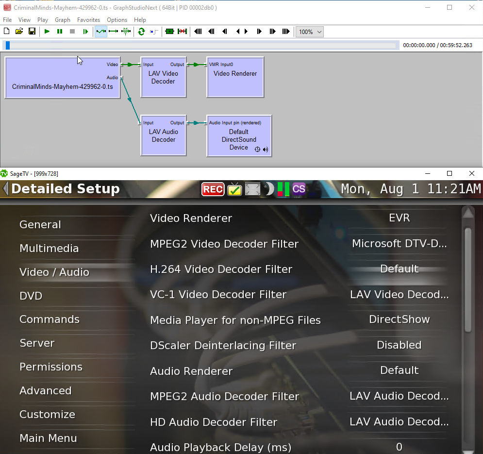

Attached is my results and what I have setup in SateTV for Video / Audio What video render is best for HD recordings? Thanks Scat

That show is Transport Stream, which is really MPEG2. You have the MPEG2 decoder set to MS DTV-DVD which isn't very good IMO. Change that to LAV Video Decoder and change H.264 to LAV Video Decoder as well.

Agreed! Go with the LAV filters and EVR. Works well for me other than Closed Caption support.
