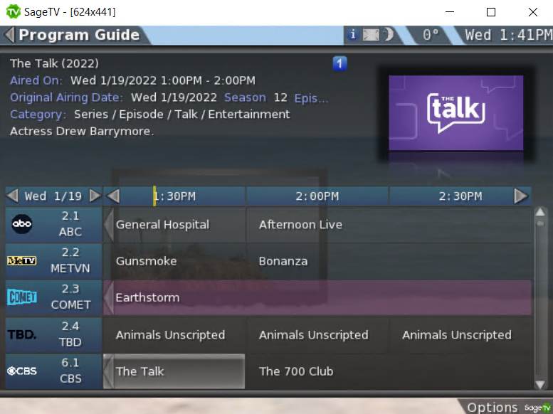

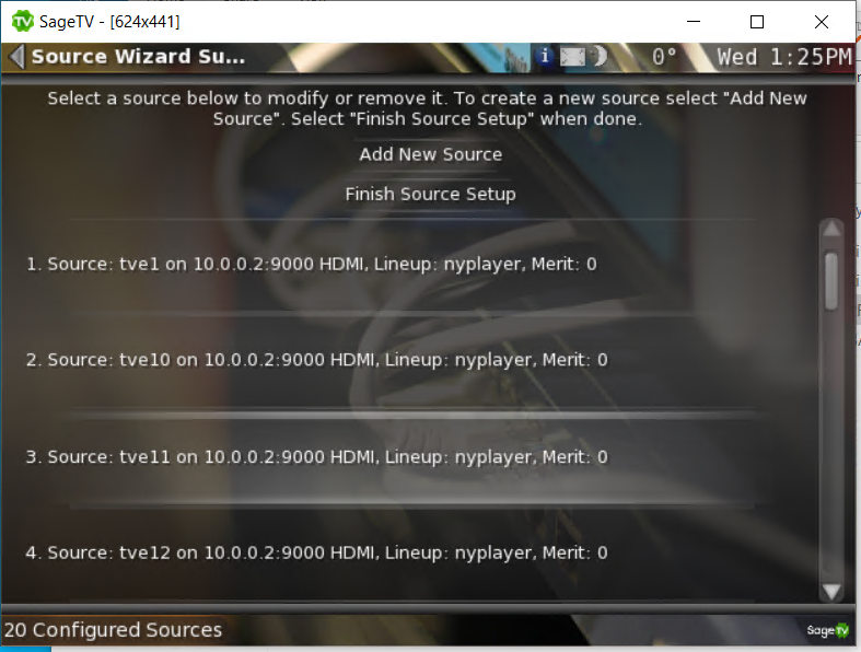

Channels DVR controls all tuners ... TVE OTA Cable and Pluto. OPENDCT is Installed in the Channels DVR Server with 20 Pipe tuners. I can use as many SagetV servers as I like ... No pooling needed as Channels DVR will handle all the tuner sharing. The 20 pipe tuners are setup like this .... sagetv.device.3572338.streaming_executable=/bin/ffmpeg -i http\://127.0.0.1\:8089/devices/ANY/channels/%c%/stream.mpg?format\=ts -c copy -f mpegts - Code:
generic.pipe.device_names_csv=tve1,tve2,tve3,tve4,tve5,tve6,tve7,tve8,tve9,tve10,tve11,tve12,tve13,tve14,tve15,tve16,tve17,tv118,tve19,tve20 ![]() ![]() ![]()
Channels DVR UBUNTU Server 2 Primes 3 Connects TVE SageTV Docker with input from Channels DVR XMLTV and M3U VIA Opendct. Last edited by nyplayer; 01-19-2022 at 03:42 PM. |
