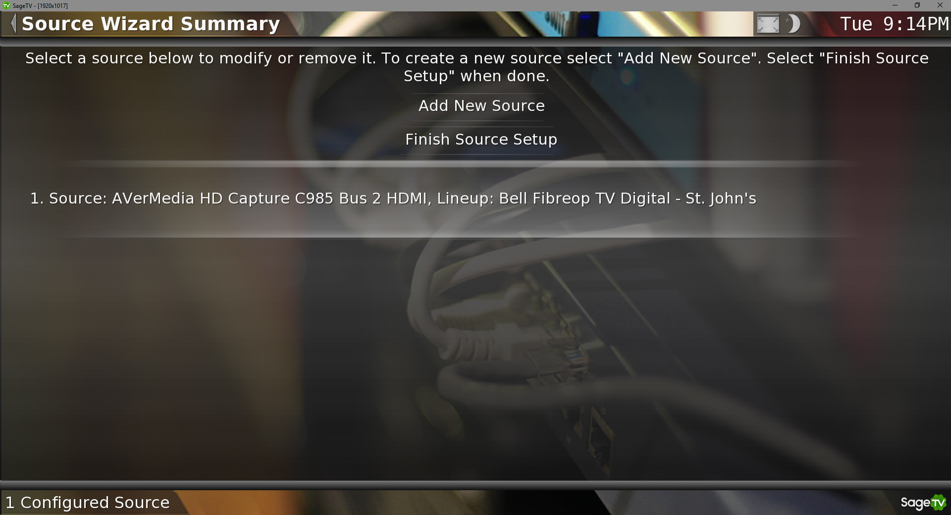

where that screenshot I req in SageTV with Live Gamer HD install from the SageTV source page so I whip up a registry so you test it to see if it works in SageTV with out a black/blank screen.
Oops, is this what you need?
So when you add a capture source it come up as (AVerMedia HD Capture C985 Bus 2) is that right ?.
