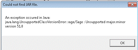

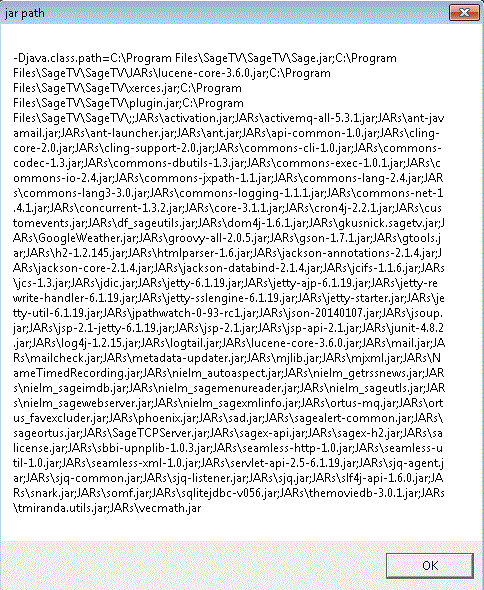

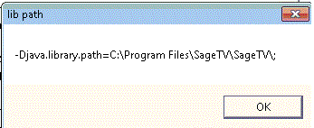

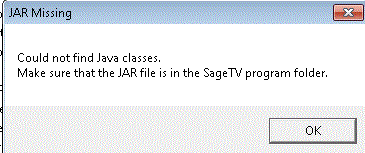

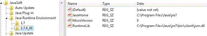

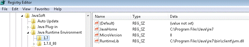

Actually bothered to start updating some things on my system @home and updated the server in preparation of installing Open DCT. Only hit a snag when trying to move from a self compiled "9.0.3.3" Jar from November 2015, to the latest 9.0.13 Jar file. The server would refuse to even launch the Java portion of SageTV. I would instead get a series of 4 error prompts from Java. (included later)

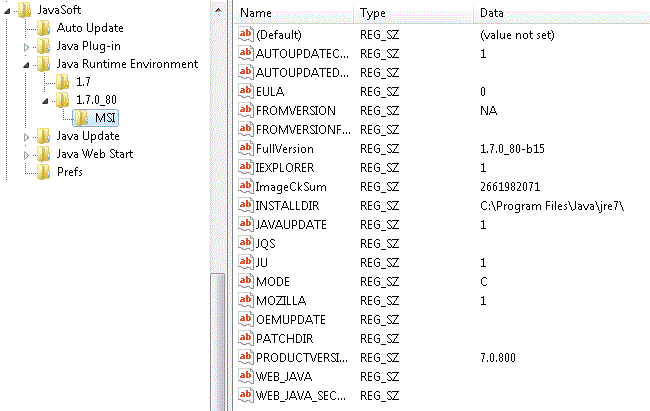

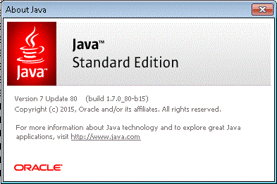

Using the Windows installer instead likewise didn't change the outcome. Regressing to several couple different earlier versions also didn't result in any kind of activity from Sage(not even a log file entry). So I reverted back to my 9.0.3.3 Jar file, confirmed everything still worked, and then worked my way forward from there until it broke. I went through the archive of updates Stuckless hosts, and the "breaking point" seems to be going from 9.0.7.369 and 9.0.8.423 at which point things break, and subsequent version produce the same results. It should be noted the server has now been updated from Java 7 update 45 to Java 7 update 80 in the course of chasing this(doesn't change the outcome). It is a Windows 7 32 bit system. Currently running 9.0.7.369 without major issue so far, but I would like to get it progressed past that point. Help is more than welcome. |

Ok, Narflex's last post in the other thread potentially nailed what the problem likely was. Haven't fully tested it yet with a newer jar file yet. But there has been a noted oddity where SageTV on the system information screen would continually insist that the server was running Java 1.6.0 for some reason even though we could find no trace of it anywhere.
Turns out it was residing in a "jre" folder within the SageTV install directory. Moved that folder outside of the Sage directory tree, and system information now claims 1.7.0_80 for the Java Version. ![]() Now to see if I can update it, and then start chasing SageTV no longer recognizing my registration key, and it rejecting my efforts to input it through the UI in 9.0.7.369(first step: stop running 7.369) Edit: SageTV v9.0.13.536 now seems to be running on the server. Now comes the fun of seeing what else may be broken. Edit 2: (Legacy) EPG is still broke on 9.0.13.539 and it is rejecting my registration keys through the client, isn't there a way to force it(through the registry?) My Hauppauge 2250 also is being very... slow/problematic in tuning into programming, so I guess I'll be looking into a driver refresh on that front to see if that helps. Last edited by Monedeath; 02-18-2017 at 02:58 PM. |
