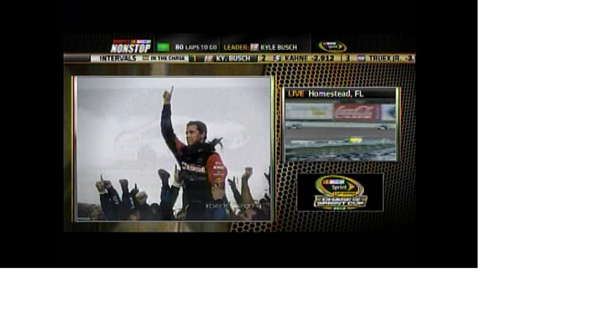

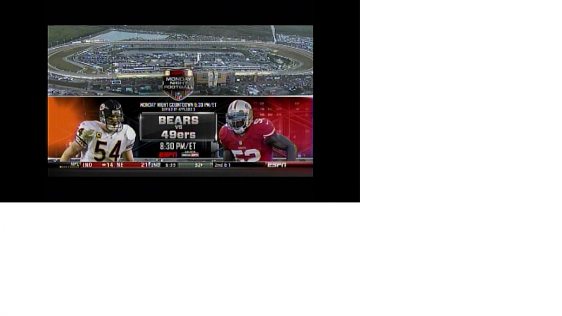

here's two screen shots. you can see the text is block and difficult to read. I've been looking through the options on the intel HD graphics utility and see a lot of color adjustments but haven't found anything (yet) to make the picture more clear. Still looking

Use the MS decoder. Skipping deinterlacing won't degrade the picture. You may see combing effect from the alternating fields, but that's not showing up in your screen grabs.
The images you posted do look somewhat mucky, but without a point of reference (your previous setup) it's hard to tell if there's in fact an issue. What we're looking at, without reference, could be interpreted as simply a poor looking original broadcast/channel.
