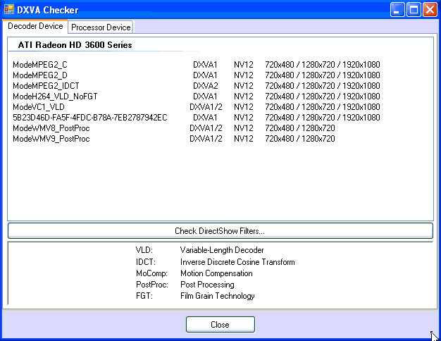

Well I'm running a P4 @ 3GHz, bit faster. But I'm running 1080p on a Benq w5000. Using an AGP 8x ASUS ATI AH3650BFG Silent.
I tried ALL the codecs I could find, until I came across the MPC Standalone filters. For h264 playback I use:
- Haali Media Splitter
- MPC Video Dec
- Ac3 Filter (SPDIF)
- Edited SageClient.properties (always_use_dshow_player=true)
- Full screen exclusive mode
mpeg2 HDHR files:
- Cyberlink PowerDVD 9 codec
I also playback files from HDHR which is 720p or 1080i. OTA.
HDHR files use around 5-8%cpu and h264 high bit rate files use around 10%.
I'm also running Windows XP sp2.
The Nvidia 8600 may playback h264. You should download DXVAChecker.
What your looking for is DXVA1 (2 is used by EVA in Windows 7).

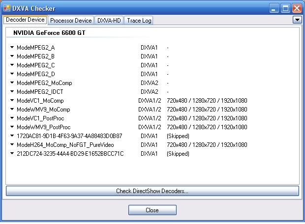

I downloaded DXVAChecker, and ran it on my PC with the Athlon (the other PC is tied up with the Spouse tonight). Here's what I got. I see DXVA1, as you suggested, but I'm not sure what it all means.
You have this:
ModeH264_MoComp_NoFGT_PureVideo
Should work with the MPC Video Decoder. If you do not want to register filters etc... Download Media Player Classic and try playing an h264 see what your CPU usage is.
If it's low cpu you can pursue downloading the MPC Standalone filters
The only file I use from the ZIP is the MPC Video Dec "MPCVideoDec.ax" drag this into your \windows\system32 directory and register it using dos
regsvr32 MPCVideoDec.ax
I download Haali Separately or you can use MatroskaSplitter.ax from the zip as well (register the same way).
h264's now should play in Windows Media Player. If they do not. You'll have to play around with DirectX Filter order and check it using GraphEdit (threads on Sage forums explain this)

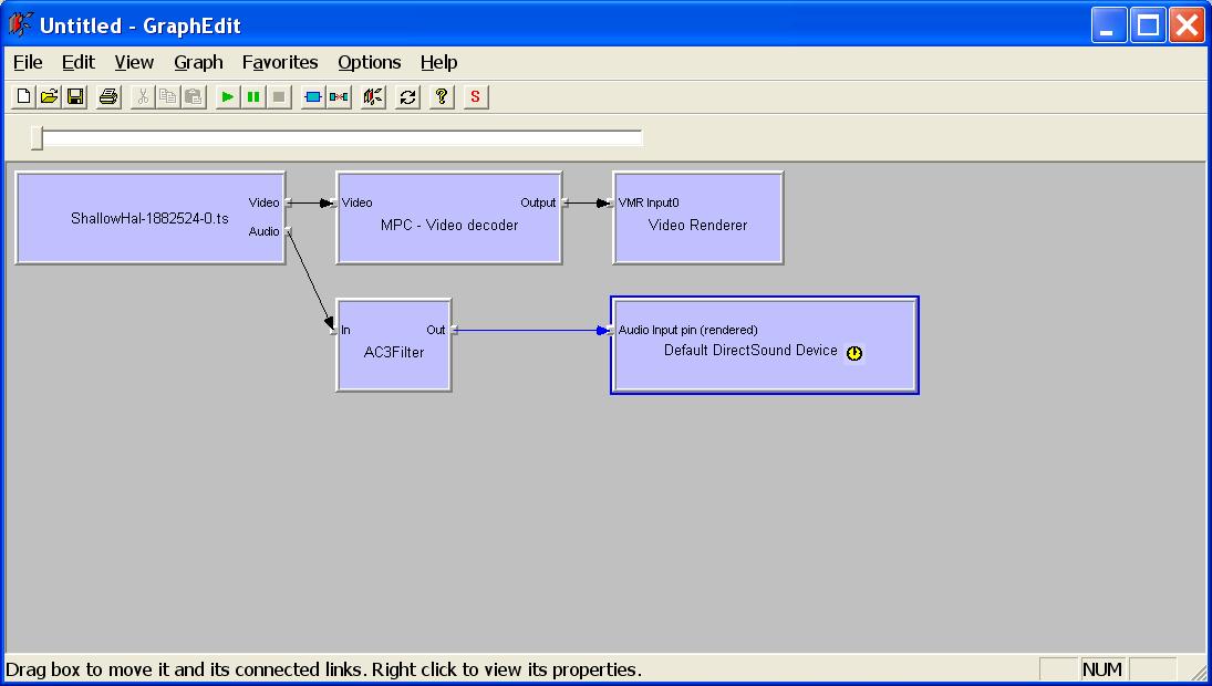

Aargh! Can't get Sage to playback .ts files. I just get a black screen. Here are the things I've done:
1) Downloaded MPC, and found that the .ts file plays well in there.
2) Downloaded and registered the MPC Video Decoder
3) Ran GraphEdit, which said it could not render the file
4) Found and installed the Haali Splitter. Now, GraphEdit can render file, and it plays beautifully (see attached graph)
5)Tried to get the file to play in Sage - Set H264 Video Decoder Filter to 'MPC - Video decoder'
6) Try to play file in sage - Black screen that just sits there
I do have the ArcSoft decoders installed from an earlier attempt - but since I'm specifically choosing MPC for the H264 decoder, should that matter?

Did the file play choppy in GraphEdit as well? For Sage to see the file you'd have to rescan your media library. Or Search -> Browse File Systems and select the file manually (Saves times on re-scans if your running a reallllllllly slow machine)
However there is no point in trying to get Sage to play the files if WMP can't. As the Sage overheads adds to the ability to playback the files.
I'm quite surprised that MPC can play the files and WMP if you the right codecs, WMP should be able too.

The good news is that the file plays smoothly MPC, and in Graphedit after hitting play. The bad news is that it played choppily in WMP (but it did play, and use the correct filters).
I will try setting the decoder for H264 to Default in Sage. I may have to decrease the merit on the Arcsoft decoder, as I think that one gets selected when I choose default for H264.
