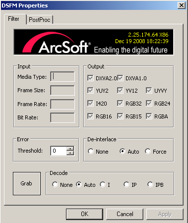

Apparently it is not enough to check the "hardware acceleration" box in TME. I downloaded "Directshow Filter Manager" and edited the properties of the filter and clear as day neither DXVA2.0 nor DXVA1.0 were enabled (screen shot attached).
So with that enabled, I rebooted (just for giggles) and turned VMR9 and 3D acceleration back on in Sage. Same kind of glitches and problems I had with the NVidia but noticeably better. I switched from the "directshow" player to "SageTV Player" and lo and behold near perfect playback.
However it's not 100%. About every 5 or 6 seconds I get blocking artifacts which are represented as black squares or corrupted video followed by a tiny skip; audio rarely skips although it did a couple of times while watching for a half hour.
So this got me tantalizingly close. I could easily chalk this up to poor performance of the onboard video and unfortunately the NVidia 8800 was not mine and I have given it back to its owner. Would anyone recommend buying a new card in light of how close PaulBeers suggestion got me? If so, what should I purchase?
File Type: png Screen shot 2010-04-21 at 12.03.24 PM.png (22.8 KB, 179 views)
Last edited by bhelmick; 04-21-2010 at 10:35 AM. Reason: Added screen shot of Arcsoft Properties Window

I got the card in on Tuesday and have been watching and tweaking settings. This is the closest I've been to perfection, but I'm still having some occasional episodes of stuttering. I'm also occasionally having sync issues. Unlike the nVidia card however the glitching is rare and the sync issue is easily remedied by clicking back in time and then to present; either way it only seems to happen once an evening or so.
My biggest complaint is the "tearing" artifacts. When I have it on overlay, or viewing in TME the display is flawless, of course in Sage the interface is still unusably slow; but the video is perfect. With VM9 however I get these tearing artifacts during motion. It makes watching live sports like hockey really annoying.
One interesting thing to note is that upon reboot, DXVA2.0 and DXVA1.0 are turned off again. This is going to sound like a total newb question, but I'm not quite sure how to keep this set permanently. Is there a registry entry that should be tweaked or something?
