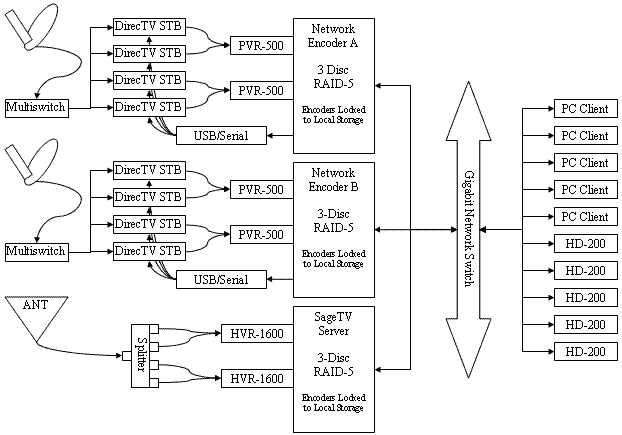

I am planning a 9 tuner system for a local school.
They have a 2 directv dishes with 8 boxes and one antenna. Here is what I am planning. Server 3Ghz, 4Gb mem, 4Tb storage via 2 2Tb drives. http://www.duropc.com/industrial_pc_...roducts_id=154 Ubuntu server 9.10 LTS Tuner card. 9 x HVR1600 http://www.hauppauge.com/site/produc...a_hvr1600.html http://www.hauppauge.com/site/compar...-internal.html (could use suggestions on selection) 8 x SageTV HD Theater They want to have TV in the cafeterias along with access via networked computers. How many concurrent clients do you think the above will handle? Suggestions on the server / tuner card? I was considering the 9 of theSilicon Dust HDHomeRun so I could use a normal workstation instead of the server with a ton of pci slots. IR suggestions to control the Sat? |

HDHomerun is OTA or digital ClearQAM. Not for use with DirectTV/Satellite. Could go with one HDHomerun for use with the OTA antenna. (If that is what is meant by "antenna" in your description.) HD-PVR is a USB device. You would need one for each DirectTV box. Could use either component (HDTV) S-video or composite inout (SDTV) This way you could use a more "traditional", better supported (thru drivers) server board. In my opinion I would use Windows for better driver support and more tuner support. (But I'm biased and not a Linux guru) Might want to give some thought to multiple NICs in the server and setting them up for teaming if you're looking for that many clients. It depends if you decide to record HD or SD. What you have should support the 8 x SageTV HD200 HD theaters. The question becomes how many networked PCs (which require either a SageTV PC client license or a Placshifter license) you are thinking about also using with the system. Gerry

I'd also question the use of only two drives in the setup. Honestly, when you look at that many tuners, writing to, and that many extenders reading from, 2 drives could very well not have the throughput required. I'd almost recommend, instead, to go with 5 or 6 smaller, faster driver, in a RAID 5 configuration, for increased performance.
More importantly, though, is what are the goals of this system? Don't get me wrong, I do love sage, but in this situation, I'm not sure it's what you really want. If you are just looking for a way of distributing those directv channels throughout the school, there are much more robust, and more traditional, distribution systems available.

Doing 9 x HVR1600 is not a good idea they run hot a lot hotter then 1800 so good venting is need here, be side you only need 8 any way after all the HVR1600 is a dual tuner so there for you can setup 2 or 4 ATSC at some time. A better way to go is 4x2250 and 2x1600 with a GA-MA770T-UD3 or GA-EP45T-UD3LR motherboard an a case 10 slots expansion. Other option PCI Express Expansion like Cyclone Microsystems - 600-2701 System Eight Slot PCI Express Expansion System there not cheap at all If you do go with 1600 get the MCE model that way you have standerd RCA Audio Jack Quote:

As for Linux unless there someone know really stuff on how use it at that school I would not recommend it, instead stick to windows. Fuzzy has a good point RAID 5 configuration, for increased performance in long run. |
And I too would look at any type of RAID configuration for speeding up the drive thruput. Gerry

1. I have seen DuroPC and your particular board and PIC setup you are looking at. I have a concern you may saturate your PCI bus with that many cards, especially if they are all taking on OTA ATSC signals. Your NIC's may also be going off the PCI bus. I think many of these systems are designed for low-rate data acquisition by science types plugging serial data acquisition cards into the slots for measurement. 2. I can't speak to HD Homerun. I think you will run into trouble if you try to use very many HD-PVR's, especially on the MB-based USB ports. If you get a PCI-based USB 2.0 card, make sure it's a NEC chipset card. But you can still saturate your bus. HVR-1600's should be a lot easier on your system though. 3. I think basic teaming with server-side load balancing will be a must for you. But, again, if your onboard NIC's or PCI NIC's use PCI bandwidth, you are going to burn what you have available. The exception would be if you had a situation, as on some Supermicro server boards, where PCI x1 lanes or seperate controllers are assigned to banks of PCI and PCI-X cards. That can get you around it. 4. I think your PS is way too small. 700+ minimum. 12V Single Rail (Corsair, some OCZ's). Multi-Rail +12V PSU's run the gammut from awesome to gimmicky and 99% of the time decide where they allocate the rails. If you are not using high-end video cards you need to keep control of the rails. You should not need much of a video card on your server side to just check videos and do basic maintenance You will also be hard pressed to know gimmicky from quality. There is NO reason not to have a single-rail +12V PSU. 5. I think you stand a problem if you were to try to substitute USB tuners for your PCI ones, not that you are. Most of the USB buses can't handle that much and some burn PCI bandwidth on top of it. 6. 2TB Hard Drives, preferrably enterprise class since you are using this in a school setting. Forget Green Drives in this case IMHWO. They load and unload the heads so many times you can ruin them quickly. 7. SLC or Enterprise-grade c: drive. Fujitsu even makes a 60GB laptop SATA II drive that is enterprise grade and no doubt big enough for what you are doing. If you are running XP, which you ought to be able to since you are using the extenders to do the "heavy lifting" decoding, you ought to be able to get a full install of XP with everything Sage needs for 8GB or so. I have a 16GB SLC drive that I have used and it flies in this scenario. 8. GbE infrasructure for sure to every extender. High-quality "prosumer" grade smart switches, not the $50 8-port switches at Staples. 9. I've never got Jumbo Frames to work so I can't speak to that if you are going to attempt it. I've never gone past basic server-side load balancing, although my switch can handle static and dynamic link aggregation. 10. Pricey, but you can look at Magma Designs. They have an x1 to PCI expansion cage. The bridge controllers are usually hardware-agnostic. (I have used an ancient Avid audio extender with PCI-based tuner cards. WinXP just sees the DEC bridge controller as another piece of hardware; no special driver software is required.) x1 is 250MB/s or 2.5Gb/s so it can handle eight cards easy. But you would need a different PIC and board combo. A different PIC and board combo may also offer you a bunch of x1 PCI express slots to work with as well. 11. Look at a PIC card and board combo with PCI express capability. PCI-X won't cut it because your 32-bit PCI cards will downgrade the slots for compatibility. You may want to consider the x1 version of the 1600 (The 1800 I think) if you go that route. 12. I don't know if your hard drive controller can handle that many simultaneous streams. I use a 3Ware RAID controller for my 8 1TB drives. 13. If you go over single-NIC cards you will either need a 100-133MHz PCI-X slot or usually an x4 PCI-Express card. 4-port cards get really pricey. I personally only trust Intel when it comes to NIC teaming attempts. It's theoretically possible that the MAC created by a teamed NIC could re-trigger a Windows re-activation requirement. Just a few thoughts. I've learned a lot of this the hard way.

I guess another approach to a system this large is to actually use some higher end PCs as a combination network encoder and clients. This way The Main SageTV server can easily support the 2 or 3 tuner cards and have two other high end PCs with 3 tuner cards each be used as a combo Network Encoder/Sage PC client. It runs the cost higher (3 total server licenses req'd but teo less PC client licenses) but if you're adding some PC as clients then the hardware part is a wash. (If you were only using existing workstations then those 2 PC would now be an additional cost.) This also gives you some flexibility in the location of the DirectTV boxes.

Joe - personally, I think I would look at a SuperMicro reseller. SuperMicro has boards that have up to 7 or 8 PCI x8 or x16 2.0 slots or some combo thereof.
They also have dual CPU boards in cases with redundant power supplies in your price range. Their quality is really there. I just think your choice of that PIC system may not be optimized for video recording. I've looked at building PIC systems and have built several SuperMicro systems. I thought they were better for video servers. Obviously SHS and I don't agree, but he is correct that your board does have dual NIC's that are on x1 slots. I could find little else out about your board or backplane. I think you could get a kick-a** SuperMicro system for around the same base price and have KVM over IP, dual 4-core CPU's, dual NIC's, etc.

This sounds like somethnig that IS doable, but I'd stick with SD for the sattelite receivers. This will significantly cut down the bandwidth requirements. Also, I think spreading the load is wise here. I'd say 3 PC's. Each, with 2 dual tuners. 3 drive RAID-5 setups in each, with the encoders locked to record to the local storage. Merits distributed across the machines.

It looks like I will need multiple servers. Will the client software or HD Theater treat them all as one? Has anyone used Red5 to stream via flash, I am considering this for the class rooms. All class rooms have interactive white boards hooked to a pc so the teacher could stream the video on her laptop to the 60+ inch board. For clarification I am trying to make something similar to this http://www.snapstream.com/enterprise...w/default.aspx that works on both windows and linux. Only standard def required. Cable in the class room programing is only SD. |
I think you need to re-evaluate and decide exactly what you need from this project. SageTV is more of a consumer product and is definitely different than the Snapstream Enterprise product. How similar are you tring to get? The Snapstream product is more a cross between a dvr and search engine for TV and finding audio bites from the cc info. The SageTV product is a DVR with media center capabilities of music, photos, dvds and online access to Youtube, Google video, etc. Two diiferent products which you are now throwing in there requirments for classroom-type capabilities. Sage should be able to handle the 9 tuner hardware and distrbution thru the network.
As far as multiple Sage servers, your clients and hd200s just talk to the main server. The main server treats the other 2 servers as just being another tuner (or 2 or 3)The main server will control the other two and tell it what to record and when to record. While they are doing that you can also run the PC client on those machines and watch just as another cleint on the network would. (The tuning and recording just happens all in the background when run as a service.) Again, if it is important that it runs on both linux and windows carefully evaluate what you are trying to accomplish and what are the goals of a successful installation. Gerry
