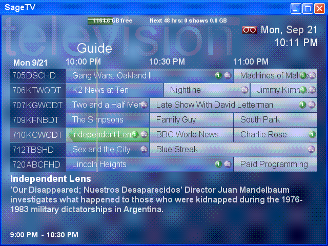

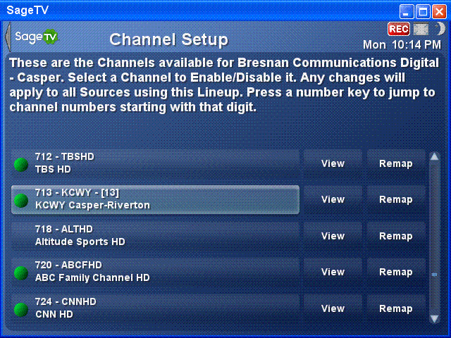

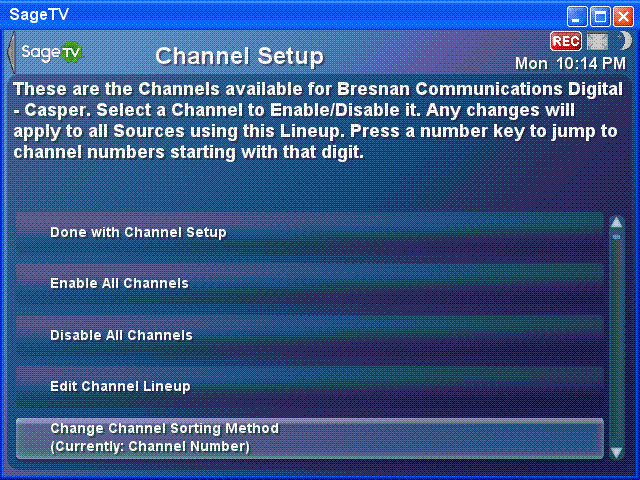

So I tried to disable and reenable, no luck. Both tuners are using the same line up. I am including screen shots to show you what I am seeing. i included the one to show how they are being sorted.
I am really getting stumped, I hope you guys aren't. Thanks for all you time and help that you are so graciously sharing. Bill
Server: Antec 300, AMD Phenom 9750, 4 gig ram, 4 tb-with pooled recording , Lite on Blu-ray drive Tuners: 2 HD-PVR, 1 HDHR Clients: 2 HD200 |
Ignore the disable/re-enable stuff.
1) Use the default STV for all testing. 2) For the 3rd time: set the Program Guide to sort the channels by name. Then, look for the name in the Program Guide to see what number it is listed at. Channel Setup's sort style is mostly irrelevant here; on the other hand, if you had set Channel Setup to sort by name you might have noticed that... 3) From your Channel Setup images, you probably have the same station at channel number 13. Disable it or the one at 713. - Andy
SageTV Open Source v9 is available. - Read the SageTV FAQ. Older PDF User's Guides mostly still apply: SageTV V7.0 & SageTV Studio v7.1. - Hauppauge remote help: 1) Basics/Extending it 2) Replace it 3) Use it w/o needing focus - HD Extenders: A) FAQs B) URC MX-700 remote setup Note: This is a users' forum; see the Rules. For official tech support fill out a Support Request. |
Ok so I got rid of my retardiness. I determined that they have the same name. So I played with it and now it doesn't even download the 713 channel at all. I can map channel 13 to 713 but my thought is:
I noticed that all the other locals etc that are HD end with DT but this is the one channel that does not. i don't know if this has anything to do with my problem or not. I have been researching and am guessing sage gets its info from zap2it. I went to the zap2it website and confirmed that this is how it is listed on the website. So if this is a zap2it issue, is there anything that can be done? Can I manually add Channel 713 to my line? If so what do I need to do
