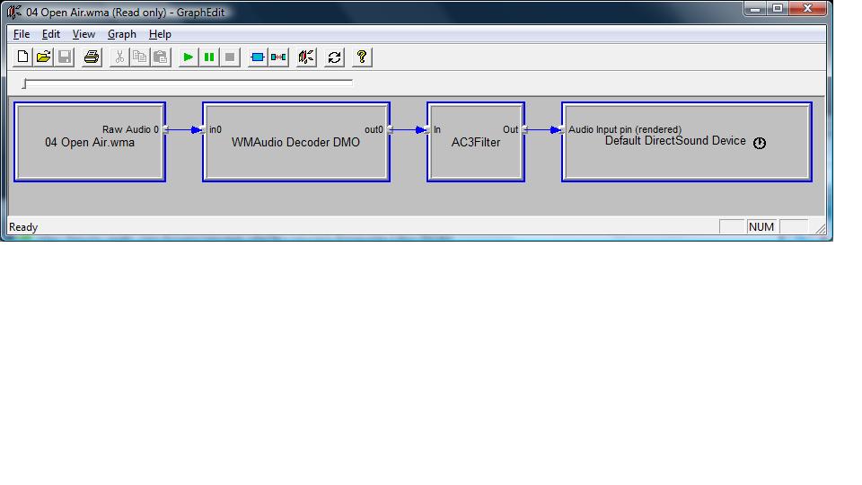

What happens when you play the MP3 in graphedit?
It will tell you what decoder windows is using so you won't have to keep guessing.

Here is a snapshot of graphedit
Here is what graphedit says
I attached a picture

Here is what I got after inputting this
I input these lines in sage.properties
always_use_dshow_player=true
videoframe/mp3_audio_decoder_filter=MPC - MPA Splitter,MP3 Decoder DMO,AC3Filter
videoframe/wma8_audio_decoder_filter=WMAudio Decoder DMO,AC3Filter
Still receiving messages:
Tue 4/7 7:57:32.316 DShowPlayer setAudioDecoderFilter0(WMAudio Decoder DMO,AC3Filter) called
Tue 4/7 7:57:32.328 Could not add specified audio decoder filter to graph hr=0x80070057
