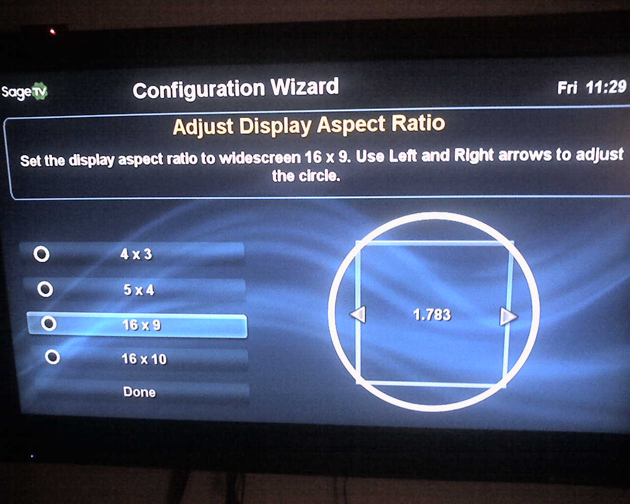

I attached is an image of what I see when I go to the aspect ratio screen. I did use the left right buttons to adjust that number from 1.783 but it had no effect on the picture. I went 10 clicks in each direction.
This is crazy as I was able to do all this cool stuff today but the simplest one is getting me stuck.
1. reboot script for my hd extender so it reboots when pc reboots
2. worked on comskip for a while with no issues
3. modified some scripts to rip dvds and do imdb lookups with cover art.
4. explained to my father how to install a NAS I sent to his house so I can have offsite backups.
But ask me to resize the screen 1/8 of an inch to get rid of a closed caption line and I am stuck.
Is the resize to 103% on this screen? really guys.. thanks so much for the handholding on this... the cc that the hdhomerun passes on is driving me crazy..

That's the Display Aspect Ratio Settings option in Detailed Setup -> Multimedia; you want the Aspect Ratio Settings, which affect the current setting for the Aspect Ratio Mode.
But unless I missed it: when trying to get help, would you please tell us what type of client you are using right at the start when posting about the issue? There are a few settings options that are not available on certain clients. On an HD100, the Aspect Ratio Settings option is not there. Instead, you would have to edit a custom aspect ratio mode while on the playback screen. And, if you are using an HD100, which the lack of icons at the top of the menu header indicates, please note that this isn't the extender forum, so people won't be thinking 'extender', unless told about it. Edit: Yup, I missed the subtle hint of "reboot script for my hd extender so it reboots when pc reboots".
