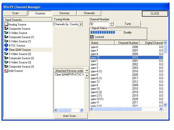

After it finishes the scan, if I go to the sources section, I dont have a "Clear QAM" under the ATSC section (or anywhere else. I want to emphasize that, it doesnt look like it even goes through a digital scan. It just stops after the first second it tries to scan for digital channels. Somethings seems screwed up in the software. I have already done an HWClear, and reinstalled the same CD version that was on the Hauppauge website.

I didn't realize until just now that you are using the 1800 version. With the 1600 using the beta Hauppauge driver you will get a clear QAM selection if your version of the card supports it. I see on the hauppauge website that your card is supposed to support clear QAM so I can only guess that you have a driver issue. Not sure if you are using the driver that came with the card but I would use that since Hauppauge claims it is supposed to work out of the box...

Hope ya get it working. Here is a pic of what you should see when the software is doing what it's supposed too.

Guess what?! It's working! Both in WinTV and SageTV. Thanks! Could you please tell me what are the minimum components I need to install in the beta CD download only for SageTV to work? Im such a minimalist, and dont want to install extra apps that wont use. (ie Wintv mpeg2 decoders, WinTV, FM Tuner, scheduler, etc).
