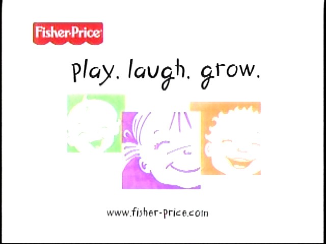

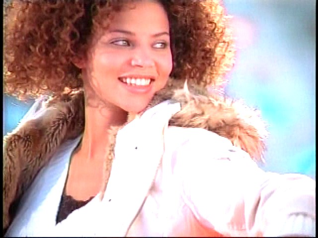

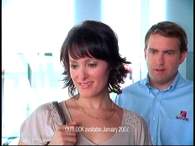

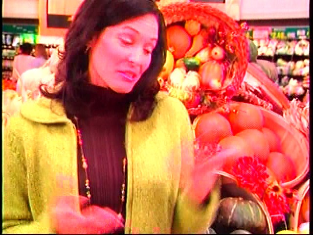

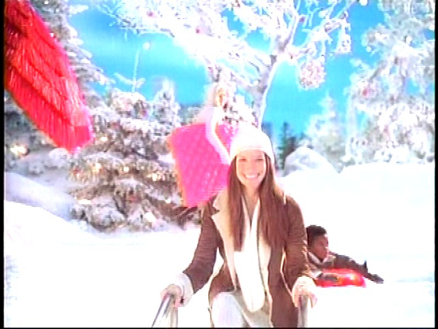

Here are some screenshots to show what I am dealing with

Thats bloody awful.
I had to recalibrate (and still doing) my two hauppauge cards when I went to the 93.71 drivers. But mine arnt near as bad as that

I must admit to being frustrated as well. I've had my DualTV for quite a while now, and fully expected full support for the card to be available in Sage before too long. I think that the problem is actually with the nVidia drivers, not Sage, but in any event the result is the same - I have a poor image that I can't adjust in Sage. It doesn't matter that the overall image quality is great if the color balance and brightness are way off.
