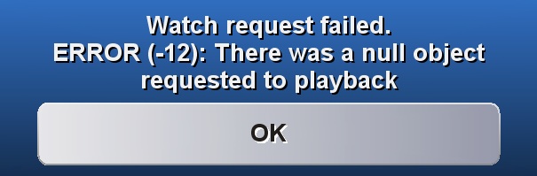

I am trying get the card setup with my Sage install (version 4.1). It is recognized by Sage and I can do a channed scan for HD channels but when I go to view any of them I get a the message attached. Dvico is the latest software download version 3.3

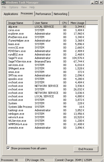

Have you made sure that all of the DVICO software is off? I think it might conflict if it's still on (check the system tray and task manager).

I turned off the stuff that was running in the system tray before I tried to setup the tuner card in Sage. I don't think any of these programs are fusion (attached screenshot)

I'm also having problems with ny Fusion. I just reinstalled my system and am using the latest release driver and release version of Sage and I can't get my FusionHDTV 5 Lite to work as either a regular cable tuner or OTA HD tuner.
When I do a channel scan on cable, I see all the channels just fine, but when I try to use it to tune, I get an error message re: audio compression.
Anyone else using the latest 3.3 drivers from DVICO? Did they add something new that has broken Sage 4.1?
