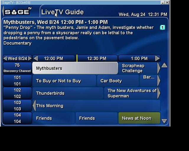

I tried adding this to a few channels and it does work, in a way...but I'm not getting the channel name in the TV Guide, just the number is displayed - in fact it's displayed twice, one of top of the other (see attached screendump).
Channels 101-104 are the ones I added the extra 'display name' line to in the XML file. The '75 Discovery' is an unedited channel.
Is this how it's supposed to look?

Nope! (looks at code)...
Ack...
Sage suppors haing a long and a short channel name.. the long name is used in channel setup screen, the short name in tv guide...
The plugin takes the longest display name as the long name, and the shortest as the short name, so it is giving the numeric displayname (the channel ID) as the short name...
There is no workaround to this without modifying the plugin code... sorry for the bad info...

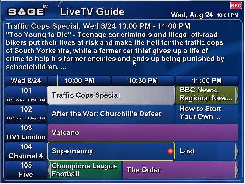

I had a poke around the plugin code and tried a few things. In the end, I came up with a fairly simple 'hack' which got the guide showing what I want.
Basically I just changed a line in Channel.java:
epg.addChannelPublic(this.shortname, this.longname, this.network, getChannelId(ProviderID));
became
epg.addChannelPublic(this.longname, this.shortname, this.network, getChannelId(ProviderID));
This appears to work (after limited testing), and produces the Guide page as in the attached file.
