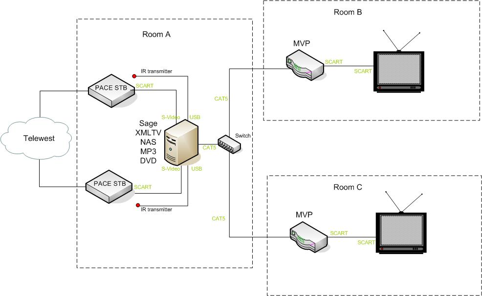

Hi all,
I want to use a sage/MVP setup and have a few questions.
I have attached a .jpg of the proposed setup and would like any suggestions.
Also, a couple of questions:
1. If I put 2 DVD players into the PC, could each MVP be allocated that DVD player so I could use both at once.
2. I will use 2 IR transmitters to change channels on 2 separate set top boxes. Will sage know which IR transmitter to use?
3. What kind of PC will I need to do this? If I am playing 2x DVD and recording/encoding 2 video streams as well as maybe playing MP3. I currently am using an AMD 2600 under-clocked to 1800 for quiet operation.
Thanks in advance:

The MVP can't handle DVD audio, it only does Mpeg2, as far as I know. As for the ir blaster, the USB-UIRT seems to be the only way to go. It has triple zone support which means one unit will control three STBs...
I have to agree, the only major problem you have listed here is the dvd playback. Now, if you're thinking you'll setup a seperate dvd drive for each mvp, and use it for ripping purposes only, then yeah, it'll probably work.
Now, that's not to say that it wouldn't be a complete waste having 2 dvd drives considering very few machines could handle ripping 2 dvd's at the same time (not only cpu, but also disk i/o.)
Anywho, drop the dvd drives, and it should work like a champ.
I am confused as to how this would work. The STBs are both exactly the same and I was planning to place them on top of each other. Won't the USB-UIRT change both at the same time?
Old 01-09-2005, 12:29 PM
Towards the bottom of this index post are some links for the USB-UIRT. Using its zone suport, you can have it control up to 3 of the same STBs if they emitters/boxes are kept isolated. If the STBs use different IR codes (or can be set to use differnt codes), then the USB-UIRT can be used to control however many boxes you have w/o worrying about the zones.
