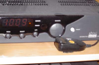

Where are most of you finding success with placement of the actisys transceiver? The cord is not long and that limits where it can be placed. When I test it the sat. box is receiving, but when I try to record something, it doesn't record the right program. The channel listings are correct.

I have mine set up so that the sat receiver is on the shelf directly below my HTPC, with the IR-200L sitting in front of the IR receiver on the sat receiver. If the actisys doesn't successfully change your receiver channel, try adjusting the delays and that should help. Delays are in the Detailed Setup.

Take a look at the attached picture. This placement has been working great for me. Is this similar to yours Mark?

My IR-200L positioning is almost identical to Dan's, sitting in front of my Dish receiver's IR port.
