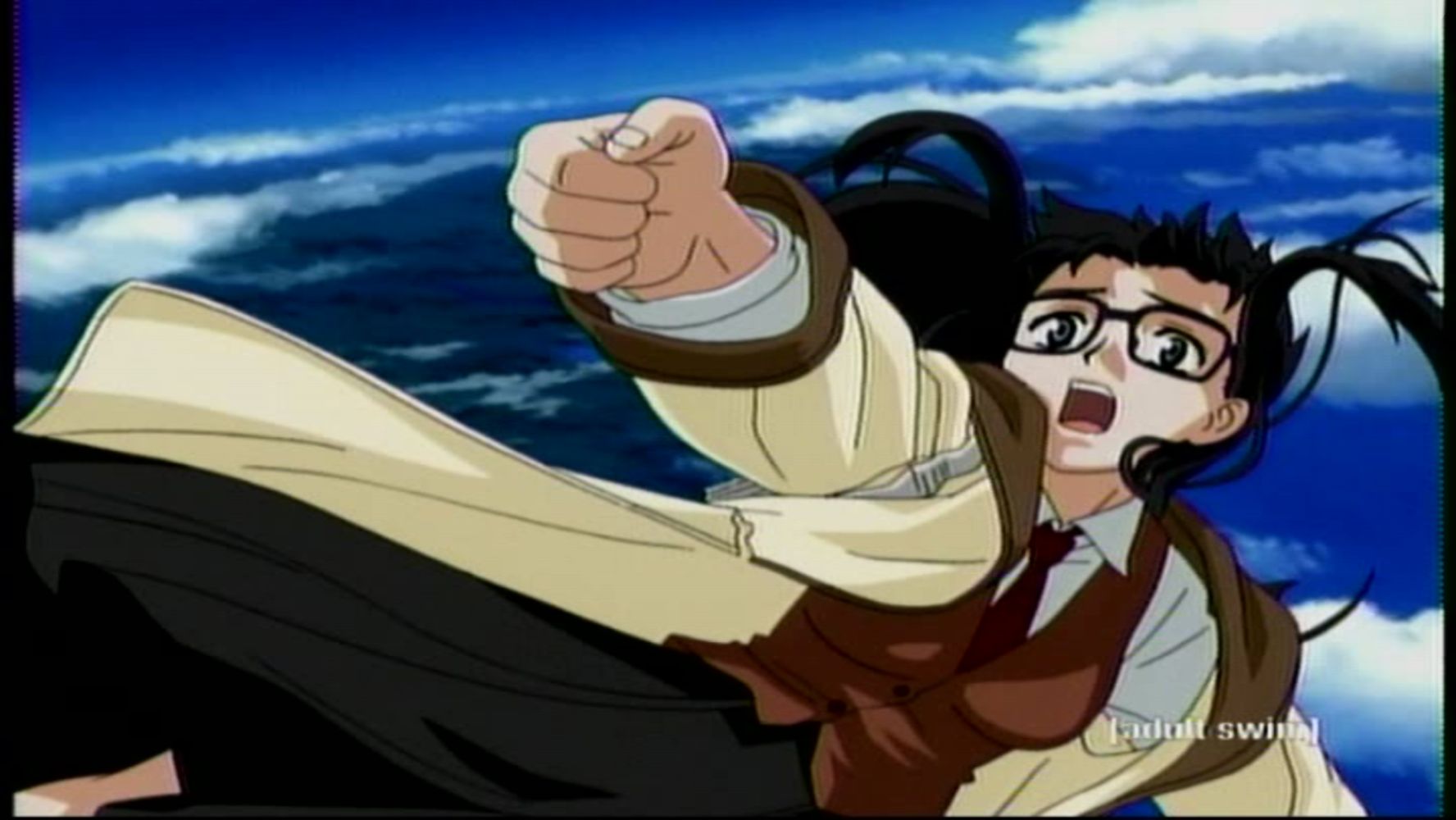

For those of you who haven't made the jump yet
nVDVD 1.00.58 (4.00.58 decoders)
Geforce 6800 (fanless) 65.90 Quadro FX 4000 drivers (inf swap)
VMR9
1776x1000i (46")
Enjoy

Oh, and for all those doubters out there, all I did was:
Install the video card drivers
Set them to High Quality, 2xQ AA, 16x Anisotropic filtering
Install the decoder pack
Set it to Hardware accelleration, Smart deinterlace control, and Pixel-Adaptive
Play
