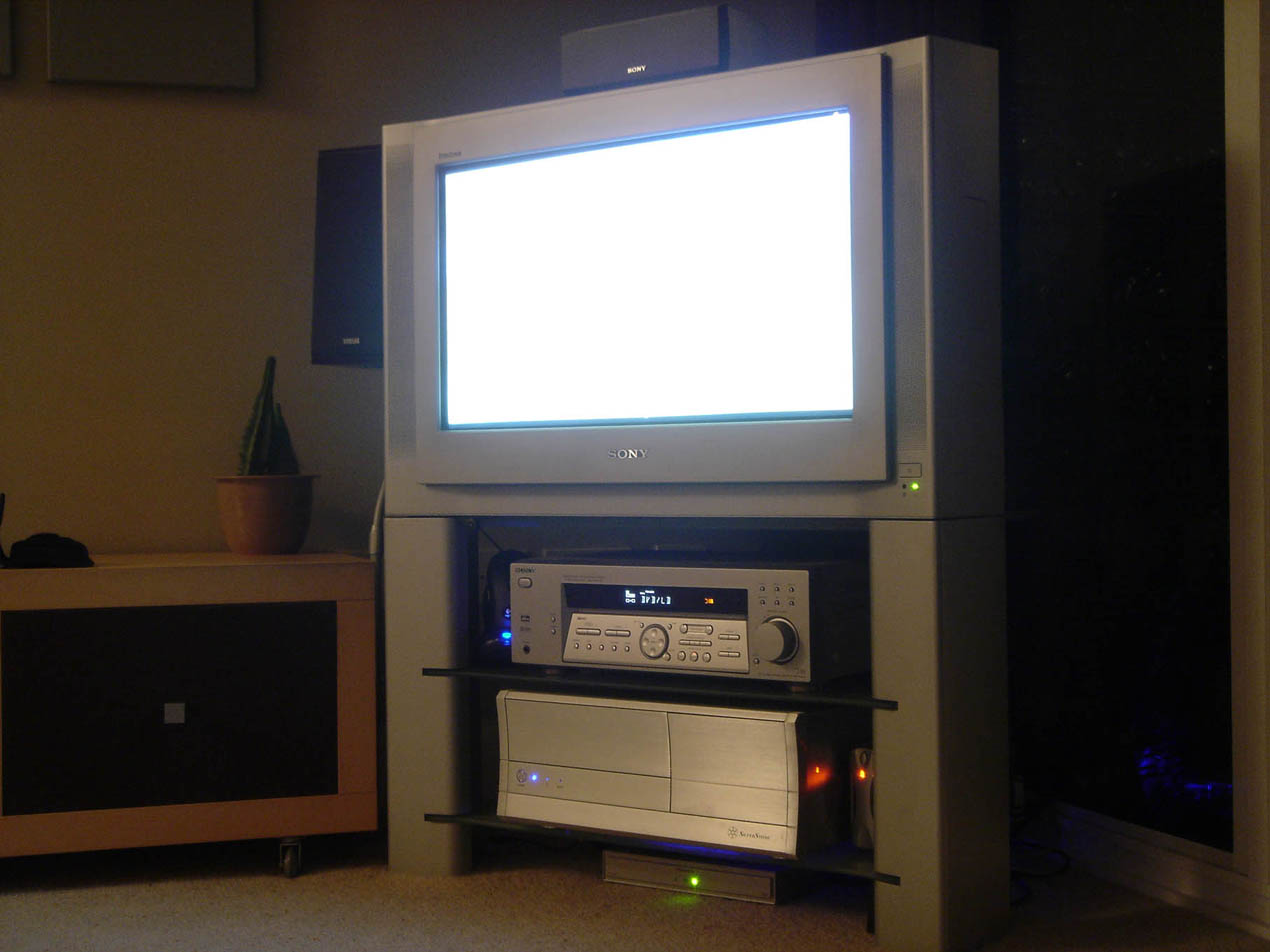

Here we go - my new case fully installed!
It is a VERY tight fit inside, but looks good from the outside!
my case is running in the high 40c and my CPU is running at about 69c. Is this ok or should I be taking drastic action?
Let me know your thoughts!

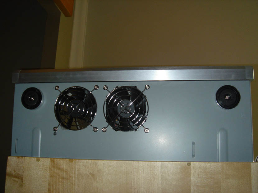

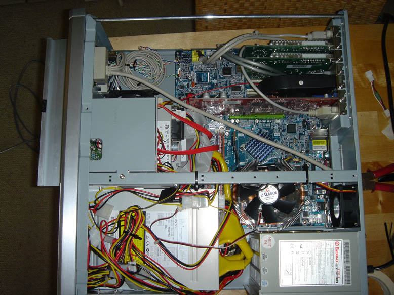

OK - so yesterday I got jiggy with the dremel!
I have cut away the grill on both the 60mm fan on the back and the 80mm fan on the base. I also put in another 80mm fan on the base directly next to the current one.
with the system under load I am now getting temps of about 41c in the case and 63/4c on the CPU. (it was about 49c case, 69c CPU).
these temps are with the fans all on their lowest speeds, including the PSU fan turned right down.
I have yet to check out the temps with fans on full (this does get a little noisy though).

here is another pic of the fans

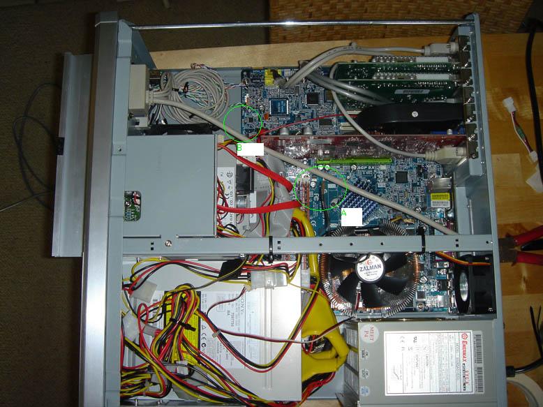

I am getting my CPU temp while Sage is running. This makes my CPU run at about 40%.
The ambient temp in my appartment is pretty high (about 28c). the HTPC is not helped by the fact the it is near some sliding patio doors, so the sun hits the side of the case.
I get the case temp from the guage that came with the fan controler. In the picture you can see it circled 'A'
I have now moved the guage to the circled 'B' position. Here, I now get a case temp of about 33c whilst using Sage.
I have also just installed a Zalman ZM80C-HP instead of the noisy little fan on my VGA card.
Another point which has helped slightly is removing the 'akasa' foam from the inside of the lid to the case where it was pressing against the PSU. This has ceartainly stopped the lid getting so hot.
I think you are right about the Zalman CPU cooler. I should probably remove it from the fan controller and just have it connected to the motherboard to get it to run at full speed.
