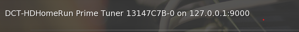

However, right after Clicking on "Add New Source" I get a page listing the HDHR Primes to choose which one I want to setup ( I see 6 - 3 for each tuner). Then I get the "Digital TV Tuner" option (which is the only choice) Which may indicate that Sage isn't really seeing or communicating correctly with the Prime. See attached - keep in mind I rename my tuners. what you should see is something similar to what was returned with TGSELL's suggestion, except this would be inside Sage. (or like what NYPLAYER posted while I was typing my response) The "channel scan" I am referring to is not inside of SageTV. It is either on the webpage for the HDHR Prime (i.e. open a browser and type in the IP address for the Prime) or in the HDHR software that comes with the Prime. The scan is to make sure the HDHR Prime sees all the channels that are available. I almost never do scans inside of Sage as part of the tuner setup. It doesn't hurt anything, just takes more time and I setup my channels manually (enable/disable) Sometimes when I mess things up with one or both of my Primes, I can hack about and get things working again. Other times, I have to go back to square one and uninstall the Prime tuners from Sage then uninstall OpenDCT - before re-installing. As a last resort that has always worked.
"Unencumbered by the thought process" The only constant in the Universe is change. Last edited by UgaData; 04-22-2022 at 05:56 PM. |
I see you renamed them just click on it and set them up. Select Digital tuner move down select ... cancel then move down hit select then select then setup your EPG. Screen Shots in order of selection.
