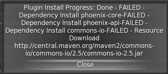

I'm doing a new install of v9 32bit on a Windows 10 x64 machine. I was originally getting download errors installing plugins, but that was (mostly) fixed by upgrading to Java 8. There are, however, still some plugins that I cannot install due to failed downloads, and they all seem to be hosted on maven.org. For example, this is what I get when trying to install Batch Metadata Tools: plugin-install-error-maven.org.JPG When I point a browser to the specified URL (http://central.maven.org/maven2/comm...ons-io-2.5.jar) I get the following: Code:
501 HTTPS Required. Use https://repo1.maven.org/maven2/ More information at https://links.sonatype.com/central/501-https-required Last edited by dexterdom; 01-16-2020 at 09:54 PM. |
I took the URL, above, changed http to https and get the following error in Firefox when I tried to go to it: "Unable to communicate securely with peer: requested domain name does not match the server’s certificate." So, they require https, but do not set their server up correctly. I came to say that you might try the following:

![]() I got it to work but I needed to jump through a couple of hoops. Thanks for pointing me in the right direction! 0) I was able to manually download the jar file without error when I pointed my browser to https://repo1.maven.org (it was in the original error message from maven.org) 1) I found the plugin definitions in SageTVPluginsV9.xml 2) per your note I copied this to SageTVPluginsDev.xml and search/repaced http://central.maven to https://repo1.maven -- sage didn't appear to be acknowledging this file, plugins were still pointing to the old location 3) tried to edit SageTVPluginsV9.xml directly but when restarting Sage that file would get overwritten with a previous copy 4) based on this thread, I set SageTVPluginsV9.xml to read-only, my changes were not overwritten when I restarted Sage and the plugin installed successfully! https://forums.sagetv.com/forums/sho...07&postcount=5 This is obviously a hack that will likely break when I update sage, but for now I have it documented in case I need to do this again in the future. Hopefully, someone who knows what they're doing will implement a more permanent fix ![]() |
The V9 repository has been changed for all the Maven links in all it's plugins
John |
Awesome! As a test, I removed my modified SageTVPluginsV9.xml file, restarted sage and saw that a new SageTVPluginsV9.xml was created with the corrected maven URLs - brilliant! Now I'll check my clients as well
