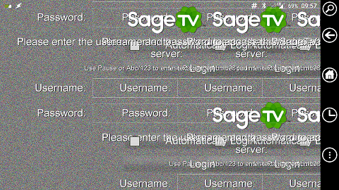

From my android Oneplus 2 phone on my own network, the miniclient connects fine and the image is great on the Linux side. On the Windows side, however, the opening screen image splits into 4 sections - each one a copy - divided vertically. (e.g., the SageTV menu on the left repeats 3 more times). Once within on the menu options, it's ok. A similar mess happens when I try to connect using LocatorID - username/password repeated 4 times and the screen image a jumble of overlays making it impossible to login. I'm attaching 3 images - the good Linux, the bad Windows and the bad placehifter login. Has anyone any idea how I can begin to try to fix this? |
Is the Windows VM considered to be on the same network as well, or, do you need a placeshifter user to connect to it. I honestly can't figure out a reason why it would be doing what you are showing.
Are all the UI/skin options for the clients set the same on both servers? How about trying to copy the contents of one properties file (on the good server) to the correct properties file for the client on the Windows system?

Thanks for the idea - I had tried that with no luck. But your suggestion made me think of trying different user interfaces and I finally had luck with Diamond instead of standard. I get the opening screen with no repeats - a great improvement! so thanks!
I had managed earlier to get in with LocatorID through the messy login screen - I could see the word LOGIN so tried pressing that and it asks for username and then password so I got in. Interestingly, since I started the Diamond UI, I no longer get the placeshifter login screen???? The other puzzle is that I seem to be always connecting to the Windows version using the Linux LocatorID but I just don't know enough about networking and routers to get that straightened out. At least now I can use this so massive progress. Thanks again for your suggestion, |
