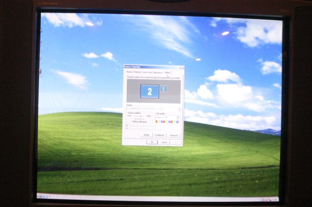

FWIW, I've attached a screenshot (via camera) of my desktop with the dongle. It's actually running 1696x1040 created via the Custom Resolution util in the Cat 4.7 drivers, 1920x1080 and 1776x1000 also work well but with more overscan.
Thanks Stragner89. I will give it a try tomorrow. Your desktop seems pretty sharp on your TV.
