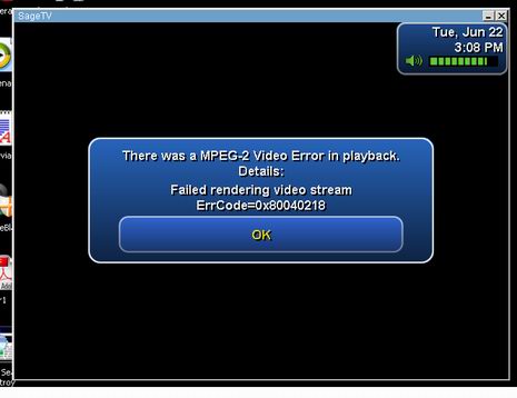

Can anyone help?
I just installed Sage, but got the followin error message when trying to watch live tv.
[IMG]http://[/IMG]
Old 06-22-2004, 04:46 PM
In Setup -> Detailed Setup -> Video, what settings do you have for your Renderer & Decoder?
Do you have an mpeg2 decoder installed?

you need to register the decoder you are using for video
sounds like the video decoder is a trial or something else

Thanks for your response.
I had to make some adjustments in setup, and rebooted. It's all good now.
I even installed Nvdvd 2.55 using those right now, there is definetly some improvement with these.
Im getting some poping and crakling on sound while watching live TV, and also what seems to be some kind of weird skipping. Appreciate any help.

change your audio decoder to default wave out
that usually cleared up the pops and such for me
and set the audio decoder to spdif
but do not use NVDVD audio decoder it has issues
the skipping is probably you using like VMR9 for rendering with 5200
try using overlay
or you could try disabling everything from starting with your computer via run and type msconfig
leave your video card drivers, remote, and sage
that should free up memory
