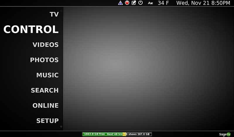

I am test driving Gemstone today. It looks great! I do have one problem though. I have the InControl plugin installed which is an interface from SageTV to my home automation system, HomeSeer. Since adding Gemstone, the "Control" main menu selection is missing on my HD200. I'm using the standard SageTV user interface on my PC and the "Control" main menu item is still in the list. I looked through the Gemstone Menu Manager, but couldn't find the missing "Control" menu item. Can I use the InControl plugin in Gemstone?
I think you will need to use copy mode from the menu manager (press option button or escape on main menu then select the menu manager) to copy the Incontrol menu item to the Gemstone custom menu.
Update: I just installed the plugin and then used copy mode to add the Control menu item to the Gemstone custom menu and it works fine. The only thing is that the background image that you normally see for "Control" when you are on that menu item does not show, but this can be added to show from the Menu Manager by assigning a background image to that menu item manually. It looks like the new menu item takes you to the Homeseer / Incontrol screen properly. Last edited by jorton; 11-21-2012 at 10:55 PM. |
I enabled the ADM Copy Mode and the InControl plugin selection is now available in the main menu. There are lots of customization options in Gemstone. It will take me some time to explore it all. Looks great, thank you!
