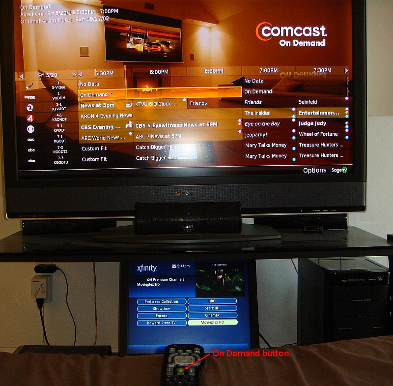

I've never heard of Insite. Please dont get your hopes up.. since this may not be something you can do. But, if they have cableboxes that are like Comcast.... Motorola DCT/DCP-series based cableboxes (R5000-compatible), you may have a chance. It's far from buying a $3.95 firewire cable on Ebay and a free sageTV plugin.
I have a feeling I might be the only person here who has a full turn-key/seemless sageTV solution for recording bit-perfect quality Comcast On Demand content such as HowardTV HD, PPV, etc using my sageTV modified MCE Remote control.. no video/audio quality-loss using component capture analog re-encoding tuners. You can forget firewire, since its almost a sure bet it's 5c protected (you can't record On Demand for sure). If R5000 is not an option, you may still be able to do this; but, you have no choice but to capture via analog output.
This is what I do (which may not work for you):
I press my custom "On Demand" button (formerly MCE green button); which turns on the "sub-display" to a Comcast On Demand screen; allowing me to use the sageTV remote control to navigate up, down, left, right, back, select/enter to play movies/shows... everything fully automated. I can record via sageTV's Program Guide.. no different than any other sageTV channel. BIG PLUS: If you're able to do this, you can also record all premium channels without restrictions; even on sageTV extenders.
Sounds too good to be true? Well here's the fine print:
1. Your cable box(s) need to be R5000 compatible (can't have a firewire port). See Nextcom Wireless website for details.
2. Costs $400 per cable box. Plus, $50 for the sageTV software addon.
3. Good knowledge of how Girder works; and, need a USB-UIRT.
If you're still interested and have questions, email me.
I just took this snapshot:

I'm not sure you really need that r5000 modded cable box. I would think we could get this to work with your normal cable box and your capture device(hdpvr, colossus,etc..)
if insight is like comcast then there's and ondemand channel you can tune to, to get to the ondemand menus. That solves 1 problem of actually getting to ondemand. Now the next problem is navigating on demand. You need the directional movements, the select/enter, and there's usually some back or exit type button. This is where I think sage fails in being able to send these to the cable box. I would think it has to be possible if you are using ir blasting, sage just needs facilitate it. For FireWire control(which I use) I would think so too, but I'm not if the solution we all use can send anything except chAnnel changes.
Now the next problem(although it looks like it's prob not really an issue from the screen shot above) is I'm not sure how the epg data is for the ondemand channel (I currently have it removed) . Since sage is always recording when you tune a chAnnel. I think the ondemand channel is possibly listed out as one loong show that never ends. But I think you want to just concentrate on viewing ondemand for now.

My intention was to prove that it can definitely be done in a best of all worlds setup; with no compromise in video/audio recorded. Some people are very picky about losing video/audio quality unnecessarily; getting the original audio/video streams worth archiving.
Anyway, more importantly, I wanted to show that it can be done using Girder+USB-UIRT to control a cable box and use a custom remote control (with a custom On Demand button) on an existing setup for relatively cheap. Although, I depend on my the R5000s' builtin channel changing capability; there's no reason why it cant be done using the USB-UIRT to control channel changing as well (on top of menu navigation control). The good news is there are definitely more than one way to do it.
I think the rest will have to be up to jredwine2857 to put the pieces together; since the technologies he needs is already available; and mentioned here; which wouldnt take more than a few days to a week to do (depending on your schedule).
BTW, There's nothing more satisfying than creating something just as dependable and usable as canned; mass-market solution canned solution that you and your family use every day. Have fun jredwine2857!!
