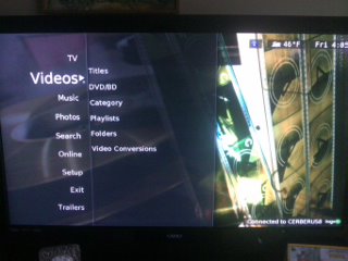

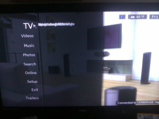

Everything seems to work fine except for the menu. When I connect to the server, it looks like image36 attached here. Pressing the down arrow will expand the garbled menu and I can navigate, but I can never get back to the 'home' menu with the left arrow (image37 attached). It's as if I had pressed the right button. Tried a different remote, tried serenity, default, and diamond themes with the same issue. Pressing 'home' while watching a show gets me back to either the garbled menu or the 'one to the right' as if I had pressed the right arrow button once.
