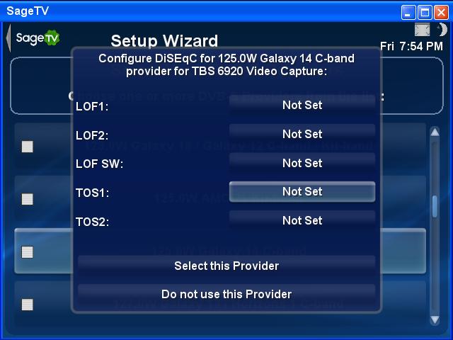

Sage see's my card, sees it as DVB-S and lets me choose the correct satalite (28.2E), then it shows a window asking for several frequencys, ive no idea what it wants here, or what any og them mean ?
I leave that blank and pres Ok then it fails to find any channels. scanning takes a few seconds and it just says it didnt find anything.

I have a TBS 6920 DVB-s/DVB-s2 pci-e card which is similar to your 8920. I can confirm this card works with SageTV. I am able to watch both dvb-s and dvb-s2 channels. I am not sure if a Diseqc switch will work in SageTV with this card, but I can confirm that a 22Khz switch will work.
Are you referring to this window? See attachment.
LOF1: Lo MHz for LNB
LOF2: Hi MHz for LNB
LOF SW: 0=22KHz tone off(uses LOF1), 11700=22KHz tone on(uses LOF2)
Diseqc switch port 1:
TOS1:A
TOS2:A
Diseqc switch port 2:
TOS1:A
TOS2:B
Diseqc switch port 3:
TOS1:B
TOS2:A
Diseqc switch port 4:
TOS1:B
TOS2:B
Try connecting the coax cable from the TBS card directly to the LNB. Then try these settings:
LOF1:9750
LOF2:10600
LOF SW:11700
TOS1:Not Set
TOS2:Not Set
