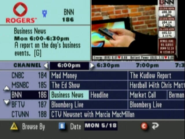

I tried bringing up the WinTV application and I still see the same effect. Interestingly, the Menu and Program Guide display an image all the way to the edge, but not the actual content. Where there are preview windows on the program guide, I can see the guide itself going past the edge of the preivew window.

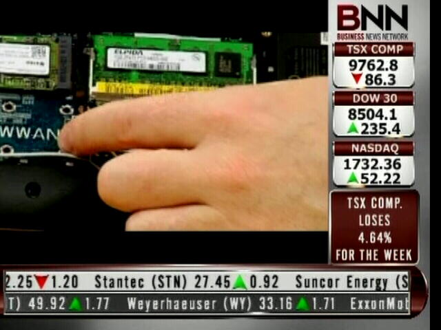

Picture with black bar on right side:
Picture with black bar on right side in a guide:

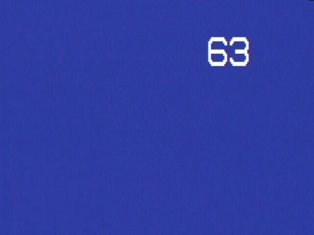

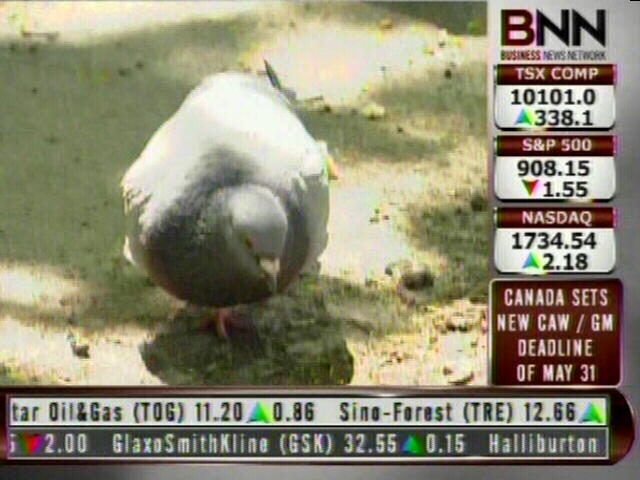

Well...I got around to trying a few other things as suggested earlier, and it's still leaving me a bit confused. I thought the overscan suggestion would definitely be it, but now I'm not sure.
1) I tried burning some of those files to disk and on an SD Television I don't really see that bar....so that overscan suggestion works here.
2) I burned an SD Letter Box recording and played it on my HD set then Zoomed it, that black bar was there on the right. Normally I have a 4250HD on my HD set and when I zoom an SD Letterbox broadcast, it always...always fills the screen. This is where I'm not so sure about the overscan, or maybe I still don't get it.
3) I hooked analogue cable to a VCR ... output the VCR to the Hauppauge 1600 with a coax. With the VCR I never saw the black bar on the right. The old VCR doesn't have an S-Video connector, so I haven't been able to test that S-Video input yet.
I also tried connecting the analogue cable straight to the TV card and it also filled the screen.
I've gone through the Explorer 3100 menus and there seems to be nothing to control it. I've tried Googling SA Explorer 3100 issues, but haven't found much useful material.
Too bad there isn't a setting on the device level of the TV card, or within Sage, to eliminate this on the recording.
For computer viewing I can live with issue, but I was hoping to get an HD200 and use both standalone and extender modes. Hopefully this unit will have an offset setting. My TV has one setting for each input but I wouldn't want to have to switch it back and forth when moving from Extender to Stand Alone mode.
